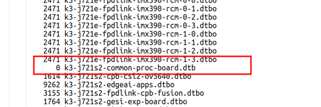

    To confirm that the patch file has successfully worked, I saw the "k3-j721s2-som-p0.dtsi" file in "<linux_sdk>/board-support/<linux*>/arch/arm64/boot/dts/ti/". The patch file has successfully included the code. However, for some reason, the EVM fails to load "k3-j721s2-common-proc-board.dtb" upon boot up.
    By the way, I am using the default edgeai image "tisdk-edgeai-image-j721s2-evm" in "/bin/mksdboot.sh".
    Ahmed
  • HI Ahmed
    Are you using 9x sdk i thought you are using 8.6 sdk
    In 9.x SDK dtbs are kept in media/<xyz>root/boot/dtb/ti/ folder whereas in 8.6 SDK  "/media/<xyz>/rootfs/boot/" folder

  • Hi Diwakar,
    I am using 8.6 SDK.
    Therefore, I placed the "k3-j721s2-common-proc-board.dtb" in "/media/<xyz>/rootfs/boot/" in my SD card.

    And, I copy the device tree "k3-j721s2-common-proc-board.dtb" file in my SD card by using this command,
    cp board-support/<linux*>/arch/arm64/boot/dts/ti/k3-j721s2-common-proc-board.dtb /media/<xyz>/rootfs/boot/
    The file successfully includes in my SD card, however, the board does not boots up and gives this error,

    ls mmc 1:2 boot/'
    the logs are,
    => ls mmc 1:2 boot/
    <DIR>       4096 .
    <DIR>       4096 ..
    <SYM>         26 Image
            19079680 Image-5.10.162-g76b3e88d56
    <SYM>         29 fitImage
             8345343 fitImage-5.10.162-g76b3e88d56
               74891 k3-am68-sk-base-board.dtb
                3108 k3-am68-sk-bb-csi2-ov5640.dtbo
                3816 k3-am68-sk-bb-rpi-cam-imx219.dtbo
                3989 k3-am68-sk-fpdlink-fusion.dtbo
               74774 k3-am68-sk-reve1-base-board.dtb
                2900 k3-am68-sk-reve1-bb-csi2-ov5640.dtbo
                3740 k3-am68-sk-reve1-bb-rpi-cam-imx219.dtbo
                1741 k3-am68-sk-rpi-hdr-ehrpwm.dtbo
                7996 k3-am68-sk-som-ddr_mem_carveout.dtbo
                2471 k3-j721e-fpdlink-imx390-cm-0-0.dtbo
                2471 k3-j721e-fpdlink-imx390-cm-0-1.dtbo
                2471 k3-j721e-fpdlink-imx390-cm-0-2.dtbo
                2471 k3-j721e-fpdlink-imx390-cm-0-3.dtbo
                2471 k3-j721e-fpdlink-imx390-cm-1-0.dtbo
                2471 k3-j721e-fpdlink-imx390-cm-1-1.dtbo
                2471 k3-j721e-fpdlink-imx390-cm-1-2.dtbo
                2471 k3-j721e-fpdlink-imx390-cm-1-3.dtbo
                2471 k3-j721e-fpdlink-imx390-rcm-0-0.dtbo
                2471 k3-j721e-fpdlink-imx390-rcm-0-1.dtbo
                2471 k3-j721e-fpdlink-imx390-rcm-0-2.dtbo
                2471 k3-j721e-fpdlink-imx390-rcm-0-3.dtbo
                2471 k3-j721e-fpdlink-imx390-rcm-1-0.dtbo
                2471 k3-j721e-fpdlink-imx390-rcm-1-1.dtbo
                2471 k3-j721e-fpdlink-imx390-rcm-1-2.dtbo
                2471 k3-j721e-fpdlink-imx390-rcm-1-3.dtbo
                   0 k3-j721s2-common-proc-board.dtb
                1614 k3-j721s2-cpb-csi2-ov5640.dtbo
                9262 k3-j721s2-edgeai-apps.dtbo
                3155 k3-j721s2-fpdlink-cpb-fusion.dtbo
                1764 k3-j721s2-gesi-exp-board.dtbo
               10142 k3-j721s2-vision-apps.dtbo

  • HI Ahmed
    Why the size is 0
    did you make sure that you are building and copying binary correctly ?

    I unmounted the SD card to check the "k3-j721s2-common-proc-board.dtb" file in my SD card, it does not shows size 0.
    total 27164
    drwxr-xr-x  2 root root     4096 Dec 18 08:06 .
    drwxr-xr-x 20 root root     4096 May  2  2023 ..
    lrwxrwxrwx  1 root root       26 May  2  2023 Image -> Image-5.10.162-g76b3e88d56
    -rw-r--r--  1 root root 19079680 May  2  2023 Image-5.10.162-g76b3e88d56
    lrwxrwxrwx  1 root root       29 May  2  2023 fitImage -> fitImage-5.10.162-g76b3e88d56
    -rw-r--r--  1 root root  8345343 May  2  2023 fitImage-5.10.162-g76b3e88d56
    -rw-r--r--  1 root root    74891 May  2  2023 k3-am68-sk-base-board.dtb
    -rw-r--r--  1 root root     3108 May  2  2023 k3-am68-sk-bb-csi2-ov5640.dtbo
    -rw-r--r--  1 root root     3816 May  2  2023 k3-am68-sk-bb-rpi-cam-imx219.dtbo
    -rw-r--r--  1 root root     3989 May  2  2023 k3-am68-sk-fpdlink-fusion.dtbo
    -rw-r--r--  1 root root    74774 May  2  2023 k3-am68-sk-reve1-base-board.dtb
    -rw-r--r--  1 root root     2900 May  2  2023 k3-am68-sk-reve1-bb-csi2-ov5640.dtbo
    -rw-r--r--  1 root root     3740 May  2  2023 k3-am68-sk-reve1-bb-rpi-cam-imx219.dtbo
    -rw-r--r--  1 root root     1741 May  2  2023 k3-am68-sk-rpi-hdr-ehrpwm.dtbo
    -rw-r--r--  1 root root     7996 May  2  2023 k3-am68-sk-som-ddr_mem_carveout.dtbo
    -rw-r--r--  1 root root     2471 May  2  2023 k3-j721e-fpdlink-imx390-cm-0-0.dtbo
    -rw-r--r--  1 root root     2471 May  2  2023 k3-j721e-fpdlink-imx390-cm-0-1.dtbo
    -rw-r--r--  1 root root     2471 May  2  2023 k3-j721e-fpdlink-imx390-cm-0-2.dtbo
    -rw-r--r--  1 root root     2471 May  2  2023 k3-j721e-fpdlink-imx390-cm-0-3.dtbo
    -rw-r--r--  1 root root     2471 May  2  2023 k3-j721e-fpdlink-imx390-cm-1-0.dtbo
    -rw-r--r--  1 root root     2471 May  2  2023 k3-j721e-fpdlink-imx390-cm-1-1.dtbo
    -rw-r--r--  1 root root     2471 May  2  2023 k3-j721e-fpdlink-imx390-cm-1-2.dtbo
    -rw-r--r--  1 root root     2471 May  2  2023 k3-j721e-fpdlink-imx390-cm-1-3.dtbo
    -rw-r--r--  1 root root     2471 May  2  2023 k3-j721e-fpdlink-imx390-rcm-0-0.dtbo
    -rw-r--r--  1 root root     2471 May  2  2023 k3-j721e-fpdlink-imx390-rcm-0-1.dtbo
    -rw-r--r--  1 root root     2471 May  2  2023 k3-j721e-fpdlink-imx390-rcm-0-2.dtbo
    -rw-r--r--  1 root root     2471 May  2  2023 k3-j721e-fpdlink-imx390-rcm-0-3.dtbo
    -rw-r--r--  1 root root     2471 May  2  2023 k3-j721e-fpdlink-imx390-rcm-1-0.dtbo
    -rw-r--r--  1 root root     2471 May  2  2023 k3-j721e-fpdlink-imx390-rcm-1-1.dtbo
    -rw-r--r--  1 root root     2471 May  2  2023 k3-j721e-fpdlink-imx390-rcm-1-2.dtbo
    -rw-r--r--  1 root root     2471 May  2  2023 k3-j721e-fpdlink-imx390-rcm-1-3.dtbo
    -rw-r--r--  1 root root    82643 Dec 18 08:15 k3-j721s2-common-proc-board.dtb
    -rw-r--r--  1 root root     1614 May  2  2023 k3-j721s2-cpb-csi2-ov5640.dtbo
    -rw-r--r--  1 root root     9262 May  2  2023 k3-j721s2-edgeai-apps.dtbo
    -rw-r--r--  1 root root     3155 May  2  2023 k3-j721s2-fpdlink-cpb-fusion.dtbo
    -rw-r--r--  1 root root     1764 May  2  2023 k3-j721s2-gesi-exp-board.dtbo
    -rw-r--r--  1 root root    10142 May  2  2023 k3-j721s2-vision-apps.dtbo
    And, I tried booting up the board, it worked for the first time, which is good.
    However, if I restart the board, it give the same error. This is strange.

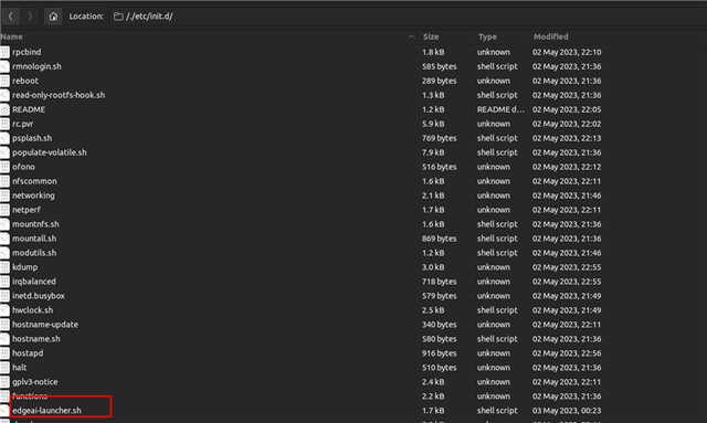

    However, after booting up the board, the original edgeai-gui is not showing? Is this because of patching?
    Ahmed
  • HI Ahmed
    Are you able to use the display or just GUI is not coming?
    Diwakar
  • Hi Diwakar,
    I think just the GUI is not coming. I tried to display the GUI using,
    etc/init.d/edgeai-launcher.sh start
    but found that there is no "edgeai-launcher.sh" in "etc/init.d/",
    ls /etc/init.d
    Did you faced this issue on your side?
    Ahmed
  • Hi Ahmed
    I dont deal with the edgeai
    If you havent changed the rootfs you should not see this kind of issue probably you have changed your rootfs .
    Diwakar
