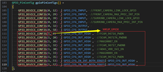

    My code is as follows, But  GPIO0_32 can not output high level; Please help me check,Thank you very much
GPIO_PinConfig gpioPinConfigs[] =
    GPIO_DEVICE_CONFIG(0, 12)  | GPIO_CFG_INPUT,  //FRONT_CAMERA_LINK_LOCK_GPIO
    GPIO_DEVICE_CONFIG(0, 29)  | GPIO_CFG_INPUT,  //FRONT_CAMERA_MAX_PMIC_INT_PIN
    GPIO_DEVICE_CONFIG(0, 39)  | GPIO_CFG_INPUT,  //SURROND_CAMERA_LINK_LOCK_GPIO
    GPIO_DEVICE_CONFIG(0, 14)  | GPIO_CFG_INPUT,  //SURROND_CAMERA_MAX_PMIC_INT_PIN
    GPIO_DEVICE_CONFIG(0, 32)  | GPIO_CFG_OUTPUT,
    GPIO_DEVICE_CONFIG(1, 6)   | GPIO_CFG_OUT_HIGH ,  //FCAM_96716_PWDN
    GPIO_DEVICE_CONFIG(1, 20)  | GPIO_CFG_OUT_HIGH ,  //SCAM_96717A_PWDNB
    GPIO_DEVICE_CONFIG(1, 26)  | GPIO_CFG_OUT_HIGH ,  //MAX20087_EN
    GPIO_DEVICE_CONFIG(1, 32)  | GPIO_CFG_OUT_HIGH ,  //FCAM_96717_PWDNB
    GPIO_DEVICE_CONFIG(1, 30)  | GPIO_CFG_OUT_HIGH ,  //ADAS_VDD_1V2_EN
    GPIO_DEVICE_CONFIG(1, 33)  | GPIO_CFG_OUT_HIGH ,  //MAX20089_EN
    GPIO_DEVICE_CONFIG(1, 35)  | GPIO_CFG_OUT_HIGH ,  //SCAM_96712_PWDN
    GPIO_DEVICE_CONFIG(1, 53)  | GPIO_CFG_IN_INT_BOTH_EDGES| GPIO_CFG_OUT_HIGH ,
    GPIO_DEVICE_CONFIG(1, 57)  | GPIO_CFG_IN_INT_BOTH_EDGES| GPIO_CFG_OUT_HIGH ,

  • Hi Daohong,
    Did you complete the pinmux configuration for GPIO0_32? You can refer to the TI SysConfig tool to help with this.
    Neehar

  • Hi Daohong,
    This pinmux configuration looks correct.
    What do you define PIN_MCASP0_AXR4 as?
    Do you have any problems with any of the other GPIOs?
    Neehar
  • Dear
    pdk_j721s2/packages/ti/board/src/j721s2_evm/J721S2_pinmux.h
    enum pinMainOffsets
     PIN_MCASP0_AXR4         = 0x080,
    ---> No

  • Hi Daohong,
    Is there a reason you use port 1 for the get and set GPIO config?
    Additionally, refer to this for any clarifications: https://e2e.ti.com/support/processors-group/processors/f/processors-forum/1126741/faq-tda4vm-using-pdk-gpio-driver.
    Neehar

  • Hi Neehar,
    the index here is 1, so the GPIO is wkup_GPIO0
    the code path:vision_apps/utils/sensors/src/app_sensors.c
    Please help me check,thank you very much.

             /* MyGPIO0 -> GPIO0_14 -> AB28 */
                PIN_MCASP0_ACLKX, PIN_MODE(7) | \
                ((PIN_PULL_DISABLE | PIN_INPUT_ENABLE) & (~PIN_PULL_DIRECTION))
                PIN_MCASP0_AXR4, PIN_MODE(7) | \
            /* MyMMCSD1 -> MMC1_SDCD -> AE25 */
                PIN_TIMER_IO0, PIN_MODE(7) | \
            {PINMUX_END}
        #define BOARD_SOC_DOMAIN_MAIN    (0)
        pinmuxModuleCfg_t gGpioPinCfg[] =
            {0, TRUE, gGpio0PinCfg},
            {PINMUX_END}
        pinmuxBoardCfg_t gJ721S2_MainPinmuxData[] =
            {0, gGpioPinCfg},
            {PINMUX_END}
        Board_pinmuxUpdate(gJ721S2_MainPinmuxData, BOARD_SOC_DOMAIN_MAIN);
        appInitGpio();
       /* Initialize timer parameters */
        TimerP_Params_init(&timerParams);
        /* Configure periodic timer for 0.00333 sec*/
        timerParams.period = 3333;  /*  0.00333 */
        timerParams.periodType = TimerP_PeriodType_MICROSECS;
        timerParams.startMode = TimerP_StartMode_USER;
        timerParams.runMode = TimerP_RunMode_CONTINUOUS;
        timerHandle = TimerP_create(TimerP_ANY, (TimerP_Fxn)&timerFxn, &timerParams);
        if (timerHandle == NULL) {
           appLogPrintf("ERR: TimerP_create failed\n");
        else
            (void)TimerP_start(timerHandle); /* start the timer */
        GPIO_write(4, 1);
        GPIO_write(5, 1);
        //GPIO_write(0, GPIO_PIN_HIGH);
        appLogPrintf(
                " appGpioInit   Done!!!\n");
        return 0;
    GPIO0_32 can't output high level
