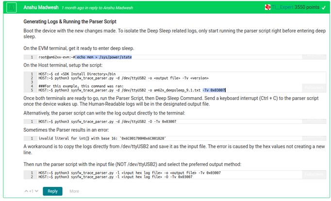

    TI EVMs have a test point that will tell you if the device is asleep by measuring the PMIC voltage: https://software-dl.ti.com/processor-sdk-linux/esd/AM62X/09_01_00_08/exports/docs/linux/Foundational_Components/Kernel/Kernel_Drivers/Power_Management/pm_low_power_modes.html#deep-sleep
    The other way is to check the Deep Sleep logs to make sure the full sequence is followed.

    Thanks for the information. Can you share the logs of when the device goes into deep sleep?
    Here is the link to the documentation about the low power modes: https://software-dl.ti.com/processor-sdk-linux/esd/AM62X/09_00_00_03/exports/docs/linux/Foundational_Components/Kernel/Kernel_Drivers/Power_Management/pm_low_power_modes.html
    You can see the expected logs of a device in deep sleep.

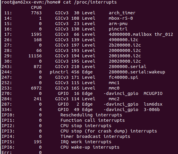

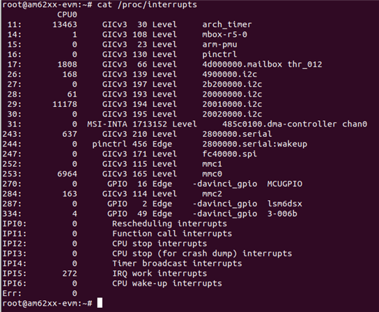

    You will need to add the device tree overlay which are shown in these steps:
    1. Compile the device tree overlay (k3-am625-sk-mcu-gpio-wakeup.dtso)
    You can follow these instructions on compiling device trees: https://software-dl.ti.com/processor-sdk-linux/esd/AM62X/09_00_00_03/exports/docs/linux/Foundational_Components_Kernel_Users_Guide.html#overview
    2. Add the device tree overlay to dts folder & uEnv.txt: https://software-dl.ti.com/processor-sdk-linux/esd/AM62X/09_00_00_03/exports/docs/linux/How_to_Guides/Target/How_to_enable_DT_overlays_in_linux.html
    3. After saving the changes, boot the device. Run cat /proc/interrupts. You should see the names of the wake up sources that were added in the overlay.
    4. Put the device into deep sleep. Assuming its successfully into deep sleep, you can ground mcu_gpio0_16 to wake it up.
    There are other wakeup sources as seen here: https://software-dl.ti.com/processor-sdk-linux/esd/AM62X/09_00_00_03/exports/docs/linux/Foundational_Components/Kernel/Kernel_Drivers/Power_Management/pm_wakeup_sources.html#mcu-gpio

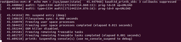

    echo mem > /sys/power/state => after issueing this command , looks something is broken . could you please help us on this ?
    => Inorder to enter deep sleep, use the following command:
    root@am62xx-evm:~# echo mem > /sys/power/state

    I added mentioned changes in dts , i found mcu_gpio in /proc/interrupts.
    as we see , MCU GPIO pin is registering in /proc/interrupts ,so for wake up what should we do .
    if suppose CPU went into seep sleep mode , then do we need to ground the MCU_GPIO pin 16  to wakeup ? what can we obsreved after grounding the MC_GPIO_16 pin ? how come to know whether CPU  is wakeup from deep sleep.?
    root@am62xx-evm:~# cat /proc/interrupts
    269: 0 GPIO 16 Edge -davinci_gpio MCUGPIO
    243: 0 pinctrl 456 Edge 2800000.serial:wakeup
    Please help us on this , we are newbies for deep sleep feature.
    Naresh

  • Hi Anshu ,
    Thank you your Quick support !
    I added cluster node in the device tree to disable the CPUs .
    I got below logs after issuing deep sleep command and stuck  at  "printk: Suspending console "means that is this went to deep sleep ?
    why it doesnot showing CPU logs then ,
    root@am62xx-evm:~#
    [ 122.470877] PM: suspend entry (deep)
    [ 122.475532] Filesystems sync: 0.000 seconds
    [ 122.488551] Freezing user space processes
    [ 122.505532] Freezing user space processes completed (elapsed 0.003 seconds)
    [ 122.512673] OOM killer disabled.
    [ 122.515935] Freezing remaining freezable tasks
    [ 122.521616] Freezing remaining freezable tasks completed (elapsed 0.001 seconds)
    [ 122.529023] printk: Suspending console(s) (use no_console_suspend to debug)
    After above logs then its stuck .....

    [ 55.256009] printk: Suspending console(s) (use no_console_suspend to debug)
    then here it is also stucks .....
    At this point we measure the PMIC voltage showing as 3.3 V only.
    From this screenshot , should i tell  from the logs , CPU went into deep sleep partially.

  • Hi Naresh,
    We cannot confirm the behavior (without logs). It could mean that the device is hanging.

    Can you change SDK versions to Linux SDK 9.1?
    In SDK 9.1, there was a feature allows for the trace logs to be stored in memory rather than through WKUP_UART0.
    Anshu

  • Hi Naresh,
    Looks like the logs are stored in R5FSS0_CORE0_ATCM which has a base address of 0x0078000000 as seen in the TRM Table 2-1. Memory Map: https://www.ti.com/lit/ug/spruiv7b/spruiv7b.pdf
    Still trying to see if there are anymore details.
    Anshu

  • Hi Naresh,
    Have you tried accessing the register?
    You should be able to use devmem2 to read it.
    Anshu

  • Hi Naresh,
    Its been a challenging to work around the lack of WKUP UART to get the R5F Trace logs. It should be possible by reading from the R5F TCMA, but the logistics of doing so is still being worked out.
    I will update as soon as possible.
    Just to confirm, is there no possibility of accessing the WKUP UART or /dev/ttyUSB2? If so, then this work around would not be required.

  • Hi Naresh,
    I've updated the E2E FAQ with the R5F TCMA method of obtaining the logs. Please see here: e2e.ti.com/.../5034765
    Try going through this and let me know if you have any questions.
    Anshu
  • Hi Anshu,
    In above screenshot,
    I observed that in board terminal gave deep sleep command .
    and in Host termal trying to accessing the deep sleep logs . But how can we access the /dev/ttyUSB2 port in host machine ?  ttyUSB2 we can access only in board/target terminal only right ?
    Naresh
  • Hi Naresh,
    /dev/ttyUSB2 is found on the Host machine when the target is connected to the Host via the UART serial connection.
    I thought that you're custom hardware does not WKUP UART as confirmed by Sai. Please correct me if needed.
    I've added a section later in the FAQ that supports the getting the logs from R5F TCMA because your custom hardware does not have WKUP UART.
    Anshu

    Please find below logs when only deep sleep command issued .
    => Logs seems to be showing CPU went into deep sleep , please confirm ?

    Could you please check below  debug main_uart0  wakeup source and MCU_GPIO wakeup source showing in /proc/interrupts .
    But If it went into deep sleep mode, what should i do with debug main_uart0 (2800000.serail:wakeup)  in order to come out of the deep sleep ?
    Kindly help on this issue.

    I tried wakup source using UART(main_uart0) .
    Below steps i followed .
    • First i did run  uart wake up source script .
    • Then i issued deep sleep command
    after issuing above deep sleep commands, i could not find any logs
    Then , after pressing the key(any key ) on main_uart0 keyboard , its coming out of the deep sleep .
    But i didnt see any interrupt on 280000.serial:wakeup
    Please find respected hexa Logs  and correcspinding deep sleep logs

    Please confirm , whether its really coming out from deep sleep by inspecting logs ?
    Naresh
  • Hi Naresh,
    Can you provide the Linux Terminal Suspend Logs?

  • Hi Anshu,
    Not getting Linux terninal suspend logs after issueing deep sleep command ( echo mem > /sys/power/state ) .
    After deep sleep commands , it suspending /waiting but not getting logs .

    With "Main_uart0" i did wakeup the CPU from deep sleep. ?
    When you enter anything in the Linux terminal after deep sleep, does it resume? If it does then, it woke up.
    Anshu
  • Hi Anshu,
    Linux
    After pressing key , it comes out of the wainting/ sleep mode.
    But i could not see any interrupt on cat /proc/interrupt.
    serial
