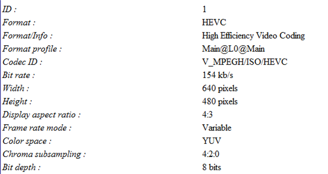

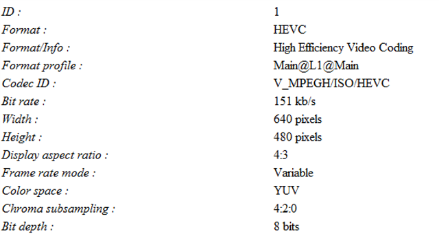

  • Hi Aymeric,
    I just ran these  pipelines on my AM62A board and I do see the difference in the files created.
    gst-launch-1.0 -v v4l2src device=/dev/video-usb-cam0 num-buffers=100 ! \
    'image/jpeg, width=640, height=480, framerate=30/1' ! jpegdec ! videoconvert ! \
    v4l2h265enc ! filesink location=usb-default.264
    v4l2h265enc extra-controls="controls, hevc_profile=1, video_bitrate=10000, hevc_level=3" ! \
    filesink location=usb-profile-level-br.264

  • Hi Suren, thank you for the test you ran!
    I tried the same pipeline as you and indeed the file sizes are different. However usb-pr0-lvl5-b100000.264 should be much larger than usb-profile-level-br.264 as the bitrate is 10 times higher. In both our screenshots usb-profile-level-br.264 is the largest file.
    I also tried saving the files to a .mkv using the following commands:
    gst-launch-1.0 -v v4l2src device=/dev/video3 num-buffers=100 ! \
    v4l2h265enc ! h265parse ! matroskamux ! filesink location=usb-default.mkv
    h265parse ! matroskamux ! filesink location=usb-profile-level-br.mkv
    v4l2h265enc extra-controls="controls, hevc_profile=0, video_bitrate=100000, hevc_level=5" ! \
    h265parse ! matroskamux ! filesink location=usb-pr0-lvl5-b100000.mkv
    usb-default.mkv: usb-profile-level-br.mkv usb-pr0-lvl5-b100000.mkv
    Using MediaInfo, we can see the bitrate of usb-profile-level-br.mkv is 40 times higher than usb-pr0-lvl5-b100000.mkv but it should be 10 times lower.
    I really hope I am doing something wrong or the version 9.1 of the SDK will fix this behavior
