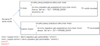

We try to boot Linux in the U-Boot SPL mode for custom board(eMMC-8GiB, TF-32GiB).
But something is bad!

(2) insert the same TF into custom board. console log is as follows:
[ 0.000000] Kernel command line: console=ttyS2,115200n8 earlycon=ns16550a,mmio32,0x02800000 \
mtdparts=47040000.spi.0:512k(ospi.tiboot3),2m(ospi.tispl),4m(ospi.u-boot),256k(ospi.env),1m(ospi.sysfw),\
256k(ospi.env.backup),57088k@8m(ospi.rootfs),256k(ospi.phypattern);47034000.hyperbus:512k(hbmc.tiboot3),\
2m(hbmc.tispl),4m(hbmc.u-boot),256k(hbmc.env),1m(hbmc.sysfw),-@8m(hbmc.rootfs) \
root=PARTUUID=cd298ceb-02 rw rootfstype=ext4 rootwait
[ 1.640670] mmc0: CQHCI version 5.10
[ 1.678275] mmc0: SDHCI controller on 4f80000.mmc [4f80000.mmc] using ADMA 64-bit
[ 2.002152] mmc0: Command Queue Engine enabled
[ 2.012604] mmc0: new MMC card at address 0001
[ 2.012877] mmcblk0: mmc0:0001 8GUF4R 7.28 GiB
[ 2.018702] cdns-ufshcd 4e84000.ufs: ufshcd_print_pwr_info:[RX, TX]: gear=[0, 0], lane[0, 0], pwr[INVALID MODE, INVALID MODE], rate = 0
[ 2.023213] mmcblk0boot0: mmc0:0001 8GUF4R partition 1 31.9 MiB
[ 2.027694] host_regs: 00000000: 1587031f 00000000 00000210 00000000
[ 2.039867] mmcblk0boot1: mmc0:0001 8GUF4R partition 2 31.9 MiB
[ 2.045716] host_regs: 00000010: 00000000 00000000 00000000 00000000
[ 2.052158] mmcblk0rpmb: mmc0:0001 8GUF4R partition 3 4.00 MiB, chardev (237:0)
[ 2.559804] Waiting for root device PARTUUID=cd298ceb-02...
[ 33.837729] tlv71033: disabling
Then there is no response anyway.
The mmc0 above should be onboard eMMC card which has no filesystem.
The filesytem is in the TF card,but kernel detect eMMC only.
The question is that why kernel only detect eMMC.
what shall we do to load rootfs from TF card while booting??

  • Hi Diwakar,
    Our board is completely new. It is based on TI-EVM(J721EXSOMG01EVM).
    The onboard emmc has no partitions. We keep rootfs in sd/tf connected to physical MMC1.
    We hope to start Linux from tf.
    Alvin
