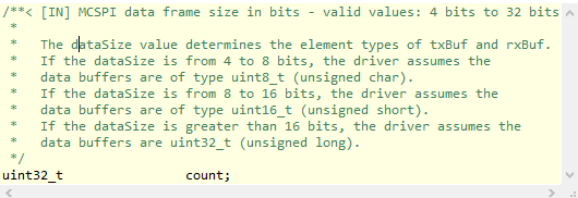

If change transmit frame size, Sould we only changing MCSPI_Transaction::dataSize?
    I would like to correct on this, so datasize is just meant to specify the number of bits. So I would recommend you to read the following.
    If you want to change the transmit size you would need to change the parameter
    spiTransaction.count
    Vaibhav
    you mean, If set "spiTransaction.count    = APP_MCSPI_MSGSIZE / (spiTransaction.dataSize/8);" or When the total amount of data to be transmitted is the same as before the frame size change?
    (this setting is MCU+SDK example mcspi_loopback_dma_am64x-sk_r5fss0-0_nortos)
    I think if not use spiTransaction.dataSize value as an argument of spiTransaction.count, or the total amount of data to be transmitted is not same as before frame size changed,  we not need change spiTransaction.dataSize.
    Because MCSPI_Transaction::count is frame count of transaction.
    GR

  • Hi Vaibhav,
    Thanks for your information.
    I understand that I need to change the value of count depending on what I want to communicate.
    GR
