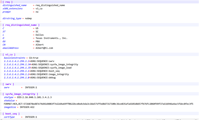

Hi engineers.
The device I use is TDA4VM HS chip.
Can I change the contents of the X509 certificate to my information, for example, the req_distinguished_name field?
After the change, can it still be verified at the safe startup?
Best Regards!

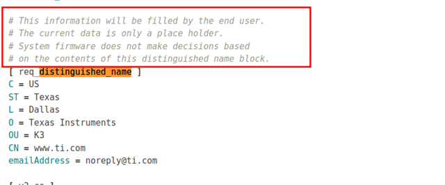

Hi Ni
software-dl.ti.com/.../sec_cert_format.html
These values are just sample template
