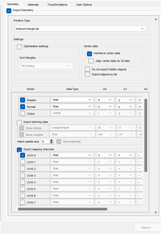

    May I ask how to configure the conversion using "Convert a Stand Alone File to POD Using" in PVRGeoPOD software?
    I tried to convert the dxf file to pod format according to the operating instructions, but the information in the above figure was not modified. Then, I replaced the original "sedan_generic. pod" file with the exported pod file, which caused segment errors during code execution.

  • Yueqian,
    There might be allocated memory for some of the models, and perhaps your POD file is larger than the one used by the original models. Can you please try a very simple model to start?

  • Hi Erick,
    OK, may I ask if it is possible to use a 2D dxf file for conversion? Because I found that in "app_srv_camera", the car model here should be three-dimensional because it can present views from ten angles.
    In addition, does the content in the above figure need to be appropriately configured? If necessary, how should I configure it?

  • Yueqian,
    I'm not sure about the 2D dxf file for conversion. It might looks strange with no depth in the model, hence can lead to not seeing it on the rendering.
    I've not tried the PVRGeoPod tool directly, I've only used the Blender extension. Did you use blender to generate your model?
