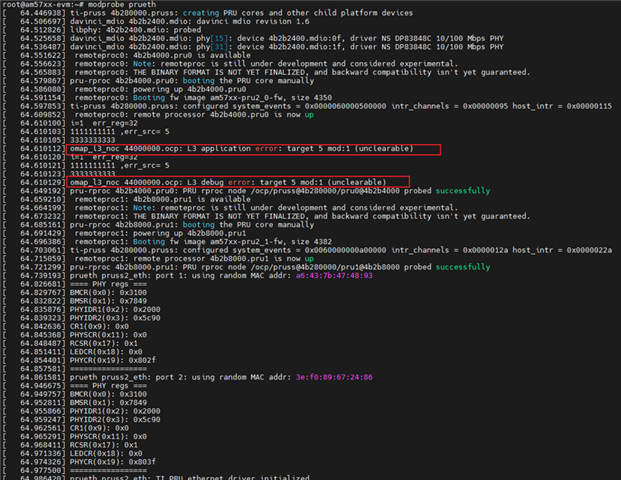

As for these "problem" boards, when we load the prueth driver, it will have the following problem logs.

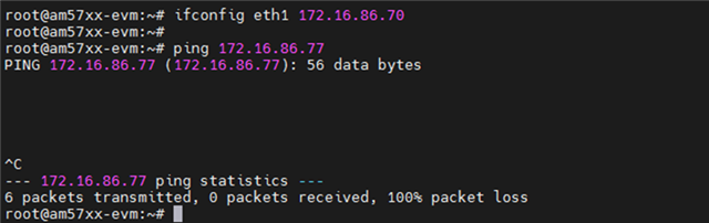

And the ping problems happen occasionally. When the problem happens, it looks like below.
When the ping problem happens, we have tried using ethtool to debug, and please see the following log, thanks!

However, we could not just take this solution. The reason is that the L3 application error and L3 debug error still exist shown below. We do not have ideas how to solve these errors for the problem boards.
For the normal boards, there is no L3 application or L3 debug error. Also the ping is always successful without writing the gpmc register.
