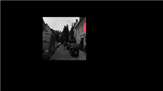

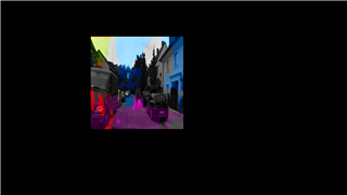

Hi, I am developing a semantic segmentation application by modifying the app_tidl_seg in Vision Apps. But I get wrong result. My working step is as follow.
1. Convert the model and run inference by edgeai-tidl-tools
This step I have no problem, and I can get the right segmentation result as below. I run following command.
python onnxrt_ep.py -c
python onnxrt_ep.py
2. modify the config file in app_tidl_seg, and run ./vx_app_tidl_seg in PC emulation mode.
For this step, I get wrong result as below.
It seems like my model is fine (because get right result in edgeai-tidl-tools), but not work in vision apps.

Why I get the right result in edgeai-tidl-tools, but wrong result in vision apps? Where might be the problem? And how to debug the inference error in vision apps?

  • Hi, I have tested more results as follow.
    Due to I use the deeplabv3plus_mobilenetv2_edgeailite model, I have tested the TI official deeplabv3plus_mobilenetv2_edgeailite model supported in edgeai_tidl_tools, which name ss-8610_onnxrt_ade20k32_edgeai-tv_deeplabv3plus_mobilenetv2_edgeailite_512x512_20210308_outby4_onnx, and the onnx file name is deeplabv3plus_mobilenetv2_edgeailite_512x512_20210308_outby4.onnx.
    Firstly, I use edgeai-tidl-tools to convert the official onnx model to tidl artifacts. And then I modify the config file in app_tidl_seg to develop this model into Vision Apps, and test it in PC emulation mode. However, I still can't get the right output. The output in Vision Apps is as follow.
    I test the deeplabv3plus_mobilenetv2_edgeailite_512x512_20210308_outby4 model in edgeai-tidl-tools by running python onnxrt_ep.py, and get the right results as follow.
    it seems that app_tidl_seg has some problem to support TI official deeplabv3plus_mobilenetv2_edgeailite model. What's the problem? How to fix it?
    My PSDK RTOS version is 09.00.00.02 and edgeai-tidl-tools version is 09_00_00_06.
    Looking for your early reply. Thanks.

  • Hi Mingzhen,
    I think what the issue here is that, the model you have compiled expects a floating point input.
    Whereas the demo, app_tidl_seg, have a preproc node, that does not support floating point.
    To check this, could you make add_data_convert_ops = 0 and recompile the model, and check if you are still facing this issue?
    https://github.com/TexasInstruments/edgeai-tidl-tools/tree/master/examples/osrt_python#advanced-options-for-accuracy-enhancement:~:text=advanced_options%3Aadd_data_convert_ops
    Also could you check in your svg if there is a data_Convert_layer present?
    Is it possible to share your svg here?
    Nikhil

  • Besides, I tested another TI official model in edgeai-tidl-tools, named ss-ort-deeplabv3lite_mobilenetv2. The model's url is https://git.ti.com/cgit/jacinto-ai/jacinto-ai-modelzoo/plain/models/vision/segmentation/ade20k32/jai-pytorch/deeplabv3lite_mobilenetv2_512x512_ade20k32_20210308.onnx.
    I find it also has a DataConvert node behind the input data node, which is shown in the below svg. But I can get the right result.
    566TIDL_cast_out_tidl_net.bin.svg.tar.gz
    And I can get the right result in Vision Apps as below.
    I have check the model structure in svg. It seems like the model strcuture of ss-ort-deeplabv3lite_mobilenetv2 is the same as deeplabv3plus_mobilenetv2_edgeailite which model's url is http://software-dl.ti.com/jacinto7/esd/modelzoo/latest/models//vision/segmentation/ade20k32/edgeai-tv/deeplabv3plus_mobilenetv2_edgeailite_512x512_20210308_outby4.onnx
    However, I can get the right results with ss-ort-deeplabv3lite_mobilenetv2 but wrong result with deeplabv3plus_mobilenetv2_edgeailite. I am so confused with that. What's the problem?
    Mingzhen Zhu
    Let me check with the TIDL expert on this regarding what is the difference between these models.
    Nikhil
  • Hi Mingzhen,
          Even though data convert layer is added in both cases, in one case data convert is doing float to int8 conversion (output_tidl_net.bin.svg) whereas in other case (566TIDL_cast_out_tidl_net.bin.svg)  its just doing int8 to int8 conversion ( this might be happening to introduce padding based on consumer layer requirement). Can you share svg file for output_tidl_net.bin.svg when you disabled the data convert ops?

    Then, I use app_tidl_seg in vision_apps to test the model in PC emulation mode. However, I still can't get the right results. The app_seg.cfg file is as below.

    And the result I get is as follow.
    It seems like there is still some problem. What's the problem? How to fix it?
    Besides, is there any documentation to introduce which parameters I should set in config file when I convert a ONNX segmentation model in TIDL-RT.
    Thanks for answering my question. Wish you a merry Christmas.
    Mingzhen Zhu
    Is there any update? Thanks.
    Mingzhen
    The app_tidl_seg, expects 5 classes. I believe you have 19 classes right?
    In the main.c of app_tidl_seg, you could see "color_map[5] [3]". Here it is hardcoded. You would have to update the same as per the comments mentioned. Could you please confirm if you have done this?
    Nikhil
  • Thanks, I have done this and the results are fine.
    Mingzhen
