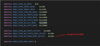

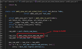

To fix this, I tried modifying the am65-cpsw-qos.c file:
#define AM65_CPSW_FETCH_RAM_CMD_NUM              0x80
Modified to:
#define AM65_CPSW_FETCH_RAM_CMD_NUM              0x8000
After the reconfiguration, there is no error, but I tested eth0.30 on J7200 and eth.30 on j7_vm, and found that the ping test failed, and the configuration qbv did not take effect.

              We made the aforementioned changes because there is a gap of 0x8000 in size between AM65_CPSW_NU_FRAM_BASE and AM65_CPSW_NU_STATS_BASE. By changing them to 0x1000 and 0x400 respectively, we were able to fill up the gap (we are unsure if the remaining space had any other purpose).

    The max cycle time allowed with the default configuration is 8ms. The cycle time you have cannot be programmed in the hardware.
    Further, there are only 128 (0x80) fetch RAM in hardware. So increasing the AM65_CPSW_FETCH_RAM_CMD_NUM will not configure the hardware correctly. See : software-dl.ti.com/.../CPSW-EST.html
    The remaining space in such cases is usually the reserved space for future features. It will not be the fetch RAM space throughout.
