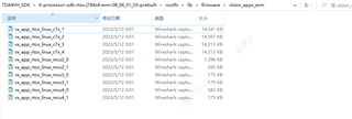

    But non-lock step mode for the main domain r5f is default application load, isn't it? it should work as it is in the SDK. Can you try with the default SDK ?
    Brijesh
    The non-lock step mode for the main domain r5f  is obtained from the ti-processor-sdk-rtos-j784s4-evm-08_06_01_03-prebuilt\rootfs\lib\firmware\vision_apps_evm directory directory.
  • Hi zheng,
    ok, sorry, what's the question here? Is non-lockstep/split mode not working for you? Have you tried with default binaries from the SDK?
    Brijesh
    My question is that after the mcu domain is configured in lockstep mode, the R core of the main domain must also be configured in lockstep mode to start normally.
    I used the default binaries from the SDK for testing.

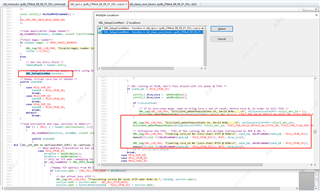

  • We were able to reproduce and identify the cause of this issue.
    I have raised the jira for the same,
     [PDK-13747] [J784s4] Boot App MCU1_0 Lock step mode crashes when loading MCU2_0 (lateapp) in split mode - Texas Instruments JIRA (ti.com)
    but the current workaround would be to hardcode the below in the function SBL_SetupCoreMem() in the file pdk_j784s4_08_06_00_31/packages/ti/boot/sbl/soc/k3/sbl_slave_core_boot.c
     - uint32_t atcm_size =  sblAtcmSize();
    - uint32_t btcm_size =  sblBtcmSize();
    + uint32_t atcm_size =  0x8000;
    + uint32_t btcm_size =  0x8000;
    Explaination:
    When MCU1_0 is in lockstep mode, the ATCM and BTCM sizes are 64KB, whereas they are 32KB when in split mode.
    The issue with the api   sblAtcmSize(); and  sblBtcmSize(); is that, since they read registers to get the size and SBL is running on MCU1_0, hence the register read is of MCU1_0 and the size for the same is assumed for other cores.
    This is valid if MCU1_0 is in split mode and size is 32KB, other cores would also be in split mode and size as 32KB.
    So if we do memset(), it will only access 32KB.
    But if MCU1_0 is in lock_step mode and size is 64KB, where as other cores in split mode are still in 32KB, resulting in accessing of region outside their reach causing core to crash.
    If MCU1_0 is in lock_step mode and size is 64KB and other cores are also in lock-step mode, then their sizes are also 64KB, so you won’t see the issue here.
    Could you please try this at your end and let me know if this resolves the issue.
    Nikhil
  • Yeah,This solution is the same as the one we currently use and can be started normally.
