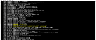

i am using tinyfs to flash using OSPI NOR and i have generated UBI file, which is causing the issue
why i am getting this prints after changing the offset addresses ->
This error is because your flash's mtd part is not sector aligned. I believe the sector size of mt25qu512a is 64KB i.e. 0x1_0000 and you have ospi_nor.rootfs and ospi_nor.lateapp2 not aligned to 64B boundary.
