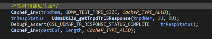

Hello Champs,
Customer modified the mcu_plus_sdk_am64x_08_03_00_18\examples\drivers\udma\udma_memcpy_interrupt\am64x-evm\r5fss0-0_nortos example, he wants to move the data from uint32_t srcData = 10 to uint32_t destData = 0; and prints the result. App_udmaTrpdInit(chHandle, trpdMem, destBuf, srcBuf, length) is the same to the example without modification. The result is printed by DebugP_log("destData = %d\r\n",destData), but the destData = 0. The function void DMAMemcpy(uint32_t *srcBuf,uint32_t *destBuf,uint32_t length) and while(!gDataSendFinishFlag) can run successfully.
Why the destData isn't updated.
Below is his code.

Shine
  • Hello Shine,
    Please add the below line after the 56th line in the above code. So, it works.
    You are not doing cache_invalidation for the destination buffer. So, data is not visible on the destination buffer.
    Please close the thread if this helps your query.
    /* Invalidate destination buffer */
    CacheP_inv(destBuf, length, CacheP_TYPE_ALLD);
    S.Anil.
  • Hi S.Anil.,
    Thank you very much for your great support.
    Customer added CacheP_inv(destBuf, length, CacheP_TYPE_ALLD); after the 56th line , but it prompted below error when executing retVal = Udma_eventRegister(drvHandle, cqEventHandle, &cqEventPrms);
    DebugP_assert(UDMA_SOK == retVal);
    Shine
  • Hello Shine,
    I am trying to understand why the customer added Udma_eventRegister(drvHandle, cqEventHandle, and cqEventPrms) function call in the customer Application.
    Customer is trying to do any SW trigger in the above example?
    I have fixed some bugs in the customer code and tested it on my side, and now the example is working fine.
    Please copy the udma_memcpy_interrupt.c file into the customer application and test it.
    Please close this thread if this helps your query.
    I have modified the code and tested it on 8.4 MCU+SDK, and the same code should be integrated into the udma_memcpy_interrupt.c file in the customer application.
    udma_memcpy_interrupt_am64x-evm_r5fss0-0_freertos_ti-arm-clang.zip
    S.Anil.
