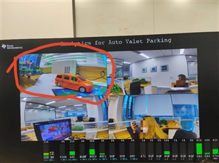

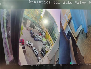

J721EXSOMXEVM: Vehicle detection based on avp4
Part Number: J721EXSOMXEVM
Hi
I want to use cameras for vehicle detection, so I delete the  post process in AVP4, then add vd's post_proc_moduleand draw_detections_module in AVP to AVP4, and then replacing the network and config of TIDL.
The images can be displayed normally,but don't display the detection box of vehicle. I pressed 'P', it displays as follows. Can you provide some advice?

  • I want to use cameras for vehicle detection, so I delete the  post process in AVP4, then add vd's post_proc_moduleand draw_detections_module in AVP to AVP4, and then replacing the network and config of TIDL.
    Not complete sure what changes were exactly added.
    Please list out the file names that you have deleted along with paths, followed by detailed explanation on post processing changes.
    Since this is custom change you have added in OpneVx based demo, can you validate the post processing node is coded correctly ? (Accepting the bounding box co ordinates, processing them them correctly ? If its yes how are you making sure that those code changes are suitable for AVP4 parking ?
    What do you mean by vd's  here ?
  • VD means vehicle detection, PSD means parking spot detection.

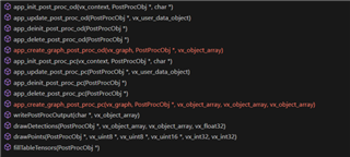

    In avp4, i deleted app_post_proc_module.c in ti-processor-sdk-rtos-j721e-evm-08_04_00_06/vision_apps/apps/dl_demos/app_tidl_avp4 ,the camera outputs yuv422, so i disabled viss, aweb, dof, hist, srv.
    I noticed that the data flow of AVP is shown in the following figure.
    So i add avp_post_proc_module.c, avp_draw_detections_module.c and fisheyes_angle_table.c in ti-processor-sdk-rtos-j721e-evm-08_04_00_06/vision_apps/apps/dl_demos/app_tidl_avp to avp4.
    About post_processing, the functins like this, i just deleted the functions xx_xx_xx_pc(related to semantic segmentation), and replaced NUM_CH by cameras enable.
    The default and updated post-processing parameters are as follows:
    static void set_post_proc_defaults_od(PostProcObj *postProcObj)
        /*Focal length is hard coded for the given camera property. It can be exposed by cfg*/
        postProcObj->params.num_max_det = 100;
        postProcObj->params.points_per_line = 64;
        postProcObj->params.num_keypoints = 4;
        postProcObj->params.focal_length = 311.833f;
        postProcObj->params.inter_center_x_fact = 10;
        postProcObj->params.inter_center_y_fact = 2;
        postProcObj->params.num_table_rows = ANGLE_TABLE_ROWS;
        postProcObj->params.output_buffer_offset = 0;
    static void update_post_proc_params_od(AppObj *obj, PostProcObj *postProcObj)

    Now, i can see the green boxes. Indoors, it seems to be able to detect many rectangular objects, but the position of the green box is not accurate, and this is also the case when detecting vehicles outdoors.
    Are these incorrect boundary coordinate boxes mainly caused by post-processing?
