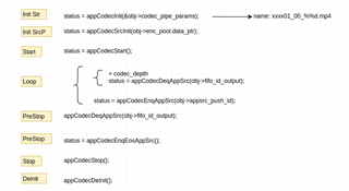

I want change the name to yyyy02_00_%%d.mp4 when counter or timer is at some condition,
restart the encoder system, or other , like set arg string func.??

hi, like the below name, I want use Date and No. named the file.
frame[0-10000]
2000_01_01_11_00_00_01.mp4 [10M]
2000_01_01_11_00_00_02.mp4 [10M]
2000_01_01_11_00_00_03.mp4 [10M]
frame[10000-20000]
2000_01_01_12_00_00_01.mp4 [10M]
2000_01_01_12_00_00_02.mp4 [10M]
2000_01_01_12_00_00_03.mp4 [10M]
thanks.

The encoder is not supported on the RTOS SDK. Unless you are pairing with Linux or QNX in the Vision Apps SDK. Additionally, there is no encoder output specific API's to modify the filename based on date/time.
Sarabesh S.
