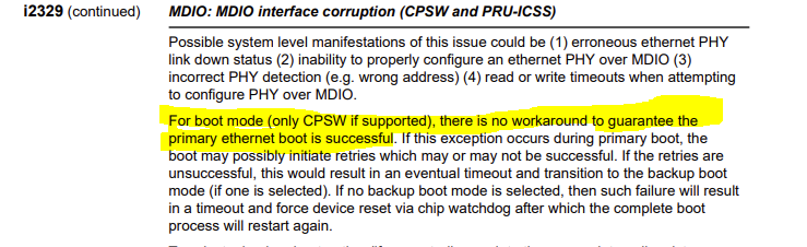

    Is the limitation due j7200-EVM board or the j7200-SOM itself? i.e. would it be possible to boot from the ethernet with a custom board?
    If the limitation is due the SOM itself, is it in the boot ROM code, or would it be possible to circumvent by customizing the R5F SPL (tiboot3.bin)? Since an earlier discussion here seems to indicate the ROM code will load tiboot3 over the ethernet.
    Best Regards
      Juha
  • Hi Juha,
    SOM itself has some Errata related to MDIO, that's where we are not claiming support for Ethernet Boot mode.
    As per internal discussion ROM code supports boot from Ethernet, but we not have software support for the same i.e. tiboot3.bin passing via Ethernet.
    Also, as per above it is not recommended for Production support.
    So, please use other boot modes.
