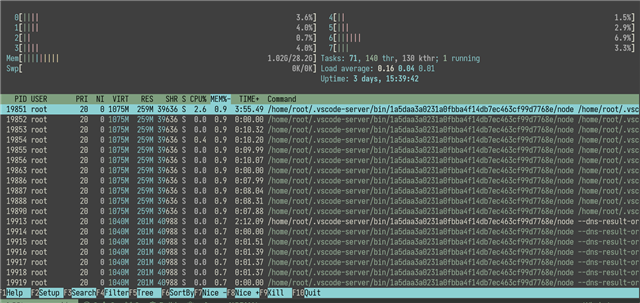

  • hi patrik,
    how could i know the size of ddr?
    i use htop on my tda4 and it show 28gb ram, does that means i have 20+gb for output tensor, so it is enough for my model?
    (my model output definitely will not be that large)
