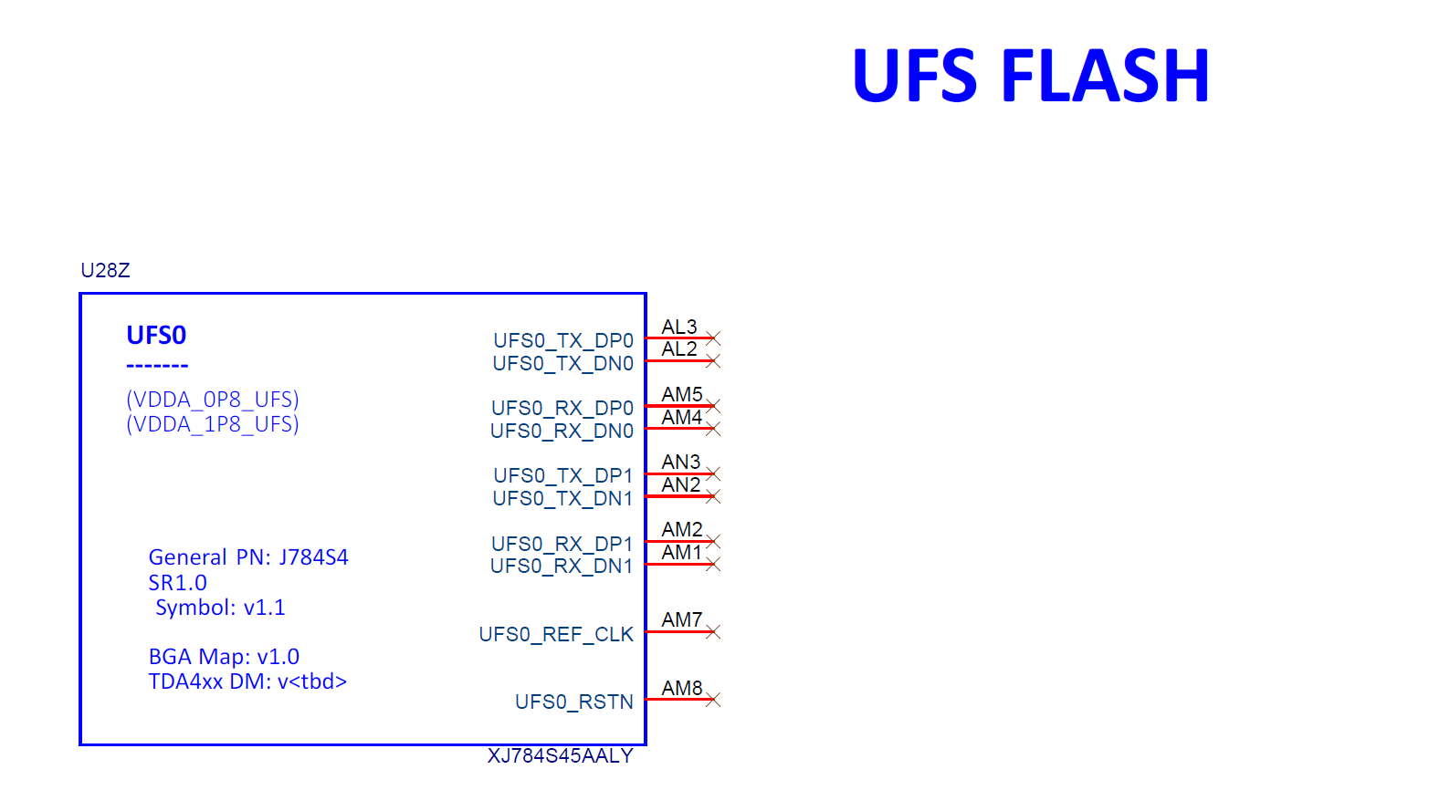

Question like in the thread title. Nothing about UFS boot in the reference manual.
Hi
As per the schematics for the SK-AM69 here, I don't think that there is a UFS flash available on the AM69 starter kit.
https://www.ti.com/lit/zip/sprr466
Karan
Hi
Just checked with the AM69A ROM team, UFS boot is not supported in this device.
