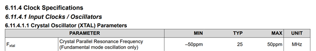

Hi team,
The AM263P4 specifies requirement for resonance frequency range of crystal as ±50ppm.
Meanwhile, the TMDSCNCD263P uses ABM10W-25.0000MHZ-8-K1Z-T3 as crystal whose frequency tolerance is ±10ppm, but its frequency stability is ±50ppm. As total, it seems violates requirement of AM263P4.
Why is the ABM10W-25.0000MHZ-8-K1Z-T3 okay?
