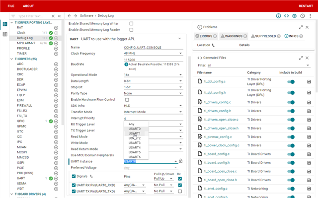

  • Hi Roland,
    I notice in your boot logs, the R5F GPIO LED BLINK application is using the same UART port for logging as used by Linux. This results in the conflict & is mostly the root cause of the issue.
    Could you please change the UART port used for logging in the R5F application from UART0 to maybe UART1 like shown below & see if the Linux boots successfully.
    Prashant
