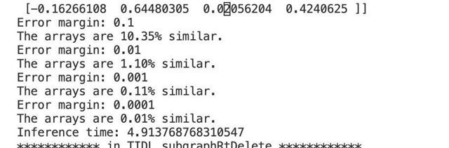

    09_01_00_02 and 08_06_00_05 tags used. For 8bit right now I don`t have results, but I will share when I test it. Here  you can see how large degradation is with same setup (number of frames, number of iterations, same model, same frames and same images for inference) between SDK 8.6 and 9.1 (add_data_ops: 0) for 16bit compilation.

    Here name is a name column of setup on which I test, error margin <number> column values show how similar are outputs of original onnx float32 model to 16bit model on this specific setup where <number> represents threshold (you can see compare_float_3d_arrays in assets). Those numbers are approximate and variate depending on sample, but you could clearly see that 09_01_00_02 (add_data_ops: 0) produce not relevant outputs at all. For all of those experiments I take same onnx model, same calibration images and options (except add_data_ops), so it feels like something wrong under the hood in this new SDK when add_data_ops: 0
    name
    error margin 0.1 error margin 0.01 error margin 0.001 error margin 0.0001
    08_06_00_05 99.70% 51.25% 5.87% 0.59%
    09_01_00_02 (add_data_ops: 1) 99.59% 48.27% 5.56% 0.54%
    09_01_00_02 (add_data_ops: 0) 10.35% 1.10% 0.11% 0.01%

  • Hi Roman,
    The observation pointed by are correct, i have verified these at my end.
    As i see, when you set the add_data_ops to 1 you get 99.59% correlation percentage, however with default i.e 0 (The same is reflected in OSRT example script) its poor. With default add_data_ops set to 0 this operation is scheduled on ARM core, and its showing functional miss match in the current case, however with flag set to 1 the same is scheduled on DSP core and its working fine.
    I have filed the JIRA to track this issue, this will be fixed in coming 9.2 release tentatively.
    Adding JIRA link for TI's internal tracking purpose.
