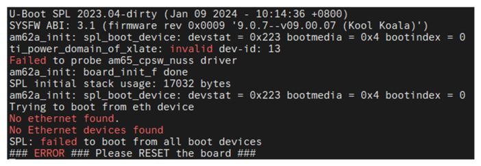

on my host: isc-dhcp-server is working, tftp server is working
I can see the tiboot3 data transfer information in wireshark, but it always gets stuck at the end of the tftp flow.
it seems like that the eth for u-boot were not properly configured.
So is there any template defconfig for am62ax ethboot ?
(wireshark screenshot)
(ttyUSB0 log)

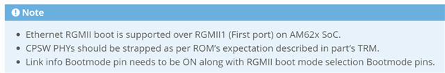

    1. I noticed that in the AM62A SDK documentation for Booting over Ethernet, there is some missing information that the AM62x SDK documentation contains. For reference, I will use the information from the AM62x SDK documentation. Have you made the Bootmode pin selections and CPSW PHY strapping as directed by the following section in the documentation?
    2. There is some additional information on the Ethernet Bootloader Operation under section 5.4.5.1 in the AM62A TRM. Specifically in section 5.4.5.1.1 Ethernet Initialization Process, as suggested by the SDK documentation, Link info should be set to 1 and the attached PHY should be configured for RGMII-ID mode since the ROM does not make this configuration change during the Ethernet initialization process.
    3. I am double checking with the team on if we have an ethboot defconfig file for AM62A and will let you know when I have updates.

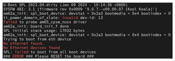

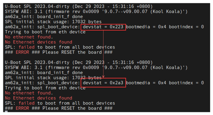

    • I've checked the boot pin configuration of my board,  link info SW2.8 is 0
    • I've tried to set the link info from 0 -> 1, it's doesn't work, you can see the boot pin changed after that (devstat read by u-boot)
    • And I have noticed that the PHY was already working with the ROM bootloader, as the u-boot R5 spl (tiboot3.bin) was successfully loaded. If tiboot3 is not loaded, there will be no u-boot spl print log, right?
    • It failed when trying to load u-boot A53 spl (tispl.bin) in my opinion
    • so it seems as if something wrong in my u-boot spl configuration for eth (defconfig file) ?

    • I've applied this patch and rebuilt u-boot, but it still failed after tiboot3 loaded.
    • I also tried with a different link info setting, same error.
    • My sdk version: ti-processor-sdk-linux-edgeai-am62axx-evm-09_00_01_03.
    (with link info = 0)
    (with link info = 1)

  • Hi Jie Li,
    After checking with the team, we realized that the patch I provided did not include (at minimum) an update to SoC auto-gen data to enable CPSW Ethernet boot. Since this is an "at minimum" change in order to enable Ethernet boot on AM62A, there might be additional changes that need to be made.
    The easiest way to get a working baseline was to create a patch with all of the most recent changes for Ethernet boot - including those we have for other SoC devices. I've attached a tarball of all patches corresponding to the most recent updates for Ethernet boot. You can ignore all the non-AM62A related patches only apply the ones related to AM62A.
    ti-u-boot-2023.04-ethernet-boot-patches-for-09.01.00.008.tar.gz
    These changes were based on the SDK v9.1 U-boot sources and I have been told they were validated on AM62Ax devices (as well as other SoC devices). If these patches continue to not work on SDK v9.0 that you are using, if possible, you could try using SDK v9.1.
    Please let us know if there are any additional issues

  • Hi Jie Li,
    Please disregard my previous message today.
    I got more information that there is a more proper patch set up. The attached patches in this post should be applied on top of ti-u-boot-2023.04-next tree's commit:
    233f462f4e configs: j7200_evm_r5_defconfig: Define K3_OPP_LOW
    Link to commit: https://git.ti.com/cgit/ti-u-boot/ti-u-boot/commit/?h=ti-u-boot-2023.04-next&id=233f462f4e
    Tree at commit: https://git.ti.com/cgit/ti-u-boot/ti-u-boot/tree/?h=ti-u-boot-2023.04-next&id=233f462f4e
    Updated patches: am62a-ethernet-boot-patches.zip

    Please give this a try and let us know how it goes.
    Daolin
