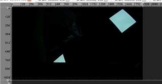

we use sdk ti-processor-sdk-linux-am62axx-evm-08.06.00.45 to debug camera KKC.A002.32(no need to config ,output yuv 422 8bit ,built-in ISP)
but the effect is too dark,we put the camera module connect to PC,it's ok,below is on PC's capture ,camera vendor said this is normal,at least 800lux
From the phenomenon of taking photos,the first few pictures are all black,I take 5 picture,show below,there is a delay phenomenon
capture yuv photo
