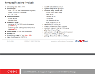

  • Hi Sushmitha,
    The camera sensor would not provide you data in NV12 format, it only supports RAW formats. You either have to use ISP to convert or videoconvert for NV12 format so the encoder can start encoding.
    The error that is shown is not able to create a pipeline as the caps are not matching from src to sink pads while creating the pipeline.
    Does adding videoconvert in the above pipeline help and are able to encode?
    Suren

    We are testing ov5640 encoding in the custom board the camera supports only UYVY format but as the v4l2h264enc supports only encoding only in NV12 format the issue is seen.
    Tried adding videoconvert plugin before v4l2h264enc in pipeline and pipeline is running properly but the issue is since videoconvert is a SW plugin it takes more time to encode the video.
    We tried tiovxdlcolorconvert and ticolorconvert plugins but the pipeline fails.
    Is there any HW accelerated plugins to convert UYVY to NV12 format?

  • Hi Vinay,
    OV5640 supports just 5MP@15fps, how are you passing 4K@30fps resolution in your pipeline.
    root@am62xx-evm:~# v4l2-ctl -d /dev/v4l-subdev2 --list-subdev-framesizes pad=0,code=0x200f
    ioctl: VIDIOC_SUBDEV_ENUM_FRAME_SIZE (pad=0,stream=0)
    Size Range: 160x120 - 160x120
    Size Range: 176x144 - 176x144
    Size Range: 320x240 - 320x240
    Size Range: 640x480 - 640x480
    Size Range: 720x480 - 720x480
    Size Range: 720x576 - 720x576
    Size Range: 1024x768 - 1024x768
    Size Range: 1280x720 - 1280x720
    Size Range: 1920x1080 - 1920x1080
    Size Range: 2592x1944 - 2592x1944
    root@am62xx-evm:~# v4l2-ctl -d /dev/v4l-subdev2 --list-subdev-frameintervals pad=0,width=2592,height=1944,code=0x200f
    ioctl: VIDIOC_SUBDEV_ENUM_FRAME_INTERVAL (pad=0,stream=0)
    Interval: 0.067s (15.000 fps)
    Also their datasheet specifies the same:
    Can you try to run with 1920x1080 or 2592x1944 resolution and see if you are able to proceed.
