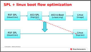

  • Hi Sathiya,
    Please check the Linux boot time optimization guidelines in the slides attached below.
    linux-boottime-optimization-public.pdf
  • On Slide 3, It is mentioned to shift from A53 to R5.
    How to do it in Yocto build environment?

  • Hello Bin Liu,
    e2e.ti.com/.../faq-am625-how-to-boot-from-r5-u-boot-spl-directly-into-the-linux-kernel-skipping-a53-spl-and-a53-u-boot-falcon-mode
    As Binman is replaced k3-image-gen in SDK 9.1, This patch has become invalid. I manually applied the patch but I got the following binman error from make u-boot sysfw-image
    So I can't generate tiboot3.bin file.

  • Hi Sathiya,
    The boot optimization work documented in the mentioned E2E FAQ has not been exercised on SDK9.1 yet, but I quickly reviewed the 3 patches provided in the FAQ (am62-r5-spl-to-kernel-boot-sdk-v08.06-13-mar-23.tar.gz) and don't see anything directly related to Binman.
    Can you please provide details of your manual patching process? Which patch has to manually applied? What is the diff after you manually applied?

  • Thanks Sathiya,
    Now I see the u-boot code has some structure changes, the patches for SDK8.x u-boot doesn't apply to the u-boot in SDK9.x anymore.
    I am not aware of any exercise internally to enable the falcon mode for u-boot in SDK9.x. But please let me check and get back to you.
  • Bin,
    Sathiya actually got the Falcon boot working, see this partially duplicate post here: https://e2e.ti.com/support/processors-group/processors/f/processors-forum/1310265/sk-am62a-lp-booting-to-linux-kernel-directly-from-r5f-spl/4980575#4980575
    There's still open questions regarding boot time optimizations (the end goal) on the other thread, feel free to chime in if you have any inputs.
