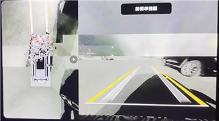

On the TDA4VM T5 machine, there was an video abnormality issue.
The pvr debug log is attached.
We are using the SDK: 8.00(tivx_queue.c and dss_m2mApi.c bugs fixed).
Can you help investigate what the problem is?

    When the problem occurs,the “HWR Event Count”  reached 28486 times,does it mean the boards experienced GPU hardware recovery?  I have analyzed the input and output frame of the GPU, the input frame is normal and output frame from the GPU is abnormal, so I confirm that the issue may be related to the GPU.

    After patching, the issue still occurred after about a week of testing. At the same time, we are constantly iterating the app code, and the problem cannot be reproduced with the new version of the app software. So we will focus on investigating the code of the APP next. Thank you.
