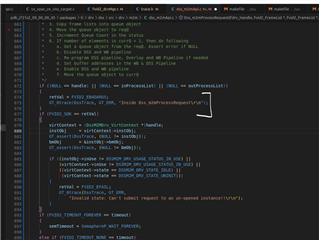

we are looking for to enable the trace logs from source files from pdk folder for debug purpose. (GT_0trace, etc..)
e.g. ti-processor-sdk-rtos-j721s2-evm-09_00_00_02/pdk_j721s2_09_00_00_45/packages/ti/drv/dss/src/*.c

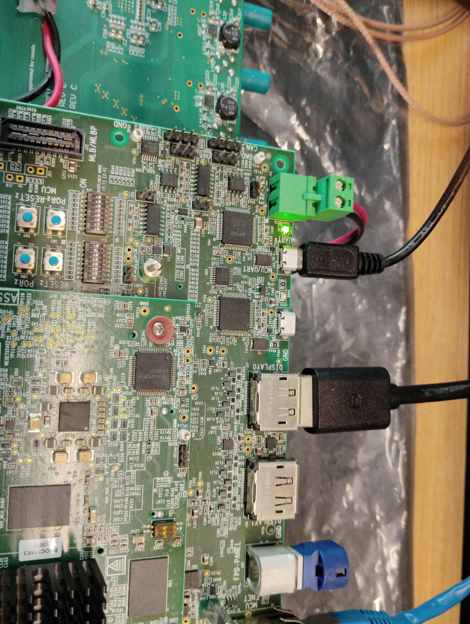

    My basic doubt is which uart port needs to be connected for mcu2.0 console?
    Presently I am just checking on following uart (J44), where we get linux boot logs and console:
  • Looks like macro - FVID2_CFG_TRACE_ENABLE needs to be enabled used in following header: trace.h
    #if part looks to be disabled:
    But macro looks be defined as follows:
    request your guidance please, to resolve our confusion.

    Are you also trying print using  GT0_trace() with DssTrace as mask and GT_ERR as class type in the file dssm2mApi.c file as shared in the screenshot?
    FVID2_CFG_TRACE_ENABLE is enabled by default. Additionally, (for eg. in DSS), DssTrace mask also enables on GT_ERR class of logs.
    This could be seen in dss_cfg.h
    To build this dss library, you could have to go to pdk repo (${PDK_PATH}/packages/ti/build) and do
    make pdk_libs CORE=mcu2_0 BOARD=j721s2_evm
    with this, please confirm if the DSS driver files got built successfully.
    After this, you could build ./make_sdk.sh, and check if the logs are printing.
    This is correct. You will get the logs along with A72 itself from MCU2_0
