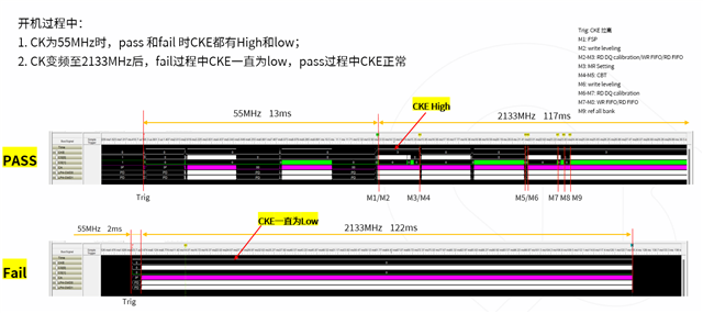

We have tried the following 6 debugging methods, and the corresponding results are provided below, pls have a look, thanks!
1: They have built 20 second generation boards, and only 1 board has this problem.
2: This is not about the soldering problem, because in the 30 time booting experiments only 3 times will have this problem. (the frequency of occurrence is about 10% for this problem board)

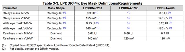

3: We have tried the experiment of decreasing the frequency, and got the below results.
      At the original frequency of 4266Mb/s, 3 times will fail out of 30 experiments, failure rate is 10%
      Decrease frequency to 3733Mb/s, 30 times will all fail out of 30 experiments, failure rate is 100%
      Decrease frequency to 3200Mb/s, 0 time will fail out of 30 experiments, failure rate is 0%

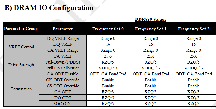

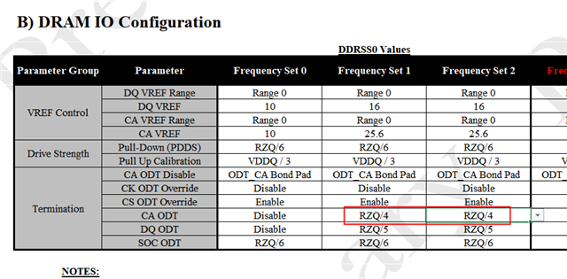

4: We have tried the experiment of changing the ODT pull down resistor of DQ/DQS, and got the below results (at the original frequency of 4266Mb/s).
     Change the ODT pull down resistor of DQ/DQS to 60ohm, 1 time will fail out of 30 experiments, failure rate is 3%
     Change the ODT pull down resistor of DQ/DQS to 80ohm, 4 time will fail out of 30 experiments, failure rate is 13%

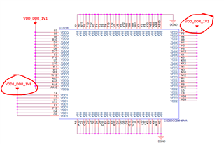

5: We have tried increasing the VDD1 (default is 1.8V) & VDD2 (default is 1.1V) a little bit, and got the below results (at the original frequency of 4266Mb/s).
      Change the VDD1 from 1.8V to 1.85V (increase 50mV), 5 time will fail out of 30 experiments, failure rate is 17%
      Change the VDD1 from 1.8V to 1.85V (increase 50mV) and change the VDD2 from 1.1V to 1.11V (increase 10mV), 3 time will fail out of 30 experiments, failure rate is 10%
      Change the VDD1 from 1.8V to 1.85V (increase 50mV) and change the VDD2 from 1.1V to 1.12V (increase 20mV), 2 time will fail out of 30 experiments, failure rate is 7%
      Change the VDD1 from 1.8V to 1.85V (increase 50mV) and change the VDD2 from 1.1V to 1.13V (increase 30mV), 2 time will fail out of 30 experiments, failure rate is 7%
      Change the VDD1 from 1.8V to 1.85V (increase 50mV) and change the VDD2 from 1.1V to 1.15V (increase 50mV), 0 time will fail out of 100+ experiments, failure rate is 0%

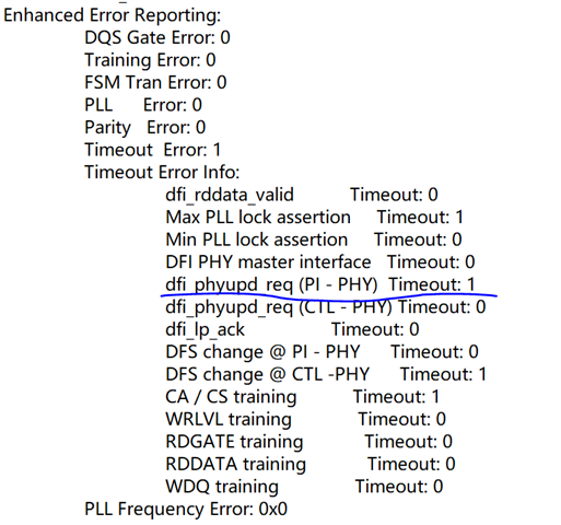

6: When the problem occurs, we have run the below suggested debugging tool. We load it to R5f core and run in the CCS, the corresponding log is attached below.
5707.tda4x_lp4_debug2.zip
Error Training Log:
Console:

Enhanced Error Reporting:
	DQS Gate Error: 1
	Training Error: 1
	FSM Tran Error: 0
	PLL      Error: 1
	Parity   Error: 0
	Timeout  Error: 1
	Timeout Error Info:
		dfi_rddata_valid           Timeout: 1
		Max PLL lock assertion     Timeout: 1
		Min PLL lock assertion     Timeout: 0
		DFI PHY master interface   Timeout: 1
		dfi_phyupd_req (PI - PHY)  Timeout: 1
		dfi_phyupd_req (CTL - PHY) Timeout: 0
		dfi_lp_ack                 Timeout: 0
		DFS change @ PI - PHY      Timeout: 0
		DFS change @ CTL -PHY      Timeout: 0
		CA / CS training           Timeout: 0
		WRLVL training             Timeout: 0
		RDGATE training            Timeout: 0
		RDDATA training            Timeout: 0
		WDQ training               Timeout: 1
	Training Error Info: 0x00007800
	Data Slice Error Info (bits [4:0]):
		Byte0: 0x00000102
		Byte1: 0x00000102
		Byte2: 0x00000102
		Byte3: 0x00000102
	PLL Frequency Error: 0xf

  • Hi Kevin,
    Thanks for providing the details of the experiments performed thus far and debug log. From the debug log, it appears write DQ training is failing.
    Can you also check the failure impact by increasing the TDA4VH supplies: VDD_CORE, VDDA_0P8_PLL_DDR0, and VDDA_PLLGRP7.
    we still need to find the root cause of this problem,
    Are you able to measure the voltages with an oscilloscope close to the memory / SOC? Two things to look for would be any potential voltage drop, or noise / glitch occurring during the training.
    Can you also see if updating the IO settings hi-lighted below has any impact on the failure?
    Kevin
  • Hi Kevin,
    We have made more experiments for tuning the CA ODT, please see the results obtained by using the ddr debug tool below.
    CA-ODT-120Ω
    	DQS Gate Error: 0
    	Training Error: 1
    	FSM Tran Error: 0
    	PLL      Error: 0
    	Parity   Error: 0
    	Timeout  Error: 1
    	Timeout Error Info:
    		dfi_rddata_valid           Timeout: 0
    		Max PLL lock assertion     Timeout: 0
    		DFI PHY master interface   Timeout: 0
    		DFS change @ CTL -PHY      Timeout: 1
    		WRLVL training             Timeout: 1
    		WDQ training               Timeout: 0
    	Training Error Info: 0x00007e00
    		Byte0: 0x00000108
    		Byte1: 0x00000108
    		Byte2: 0x00000108
    		Byte3: 0x00000108
    	PLL Frequency Error: 0x0
    	DQS Gate Error: 0
    	Training Error: 0
    	FSM Tran Error: 0
    	PLL      Error: 0
    	Parity   Error: 0
    	Timeout  Error: 1
    	Timeout Error Info:
    		CA / CS training           Timeout: 1
    	DQS Gate Error: 0
    	Training Error: 0
    	FSM Tran Error: 0
    	PLL      Error: 0
    	Parity   Error: 0
    	Timeout  Error: 1
    	Timeout Error Info:
    	DQS Gate Error: 0
    	Training Error: 1
    	FSM Tran Error: 0
    	PLL      Error: 0
    	Parity   Error: 0
    	Timeout  Error: 1
    	Timeout Error Info:
    	Training Error Info: 0x00000600
    		Byte0: 0x00000100
    		Byte1: 0x00000100
    		Byte2: 0x00000100
    		Byte3: 0x00000100

    When we see the above log, we find there is a dfi_phyupd_req timeout shown below. Could you give some glue about in which situations this timeout would happen?
    Also, we found that when CK is 55MHz, CKE has both high and low for both of the pass and fail tests. However, when CK frequency changes to 2133MHz, the CKE is always low for the fail test, it is normal for the pass test shown below.
    May I know what would be the actions of memory controller and DDR when the CK is 55MHz?
    Thanks a lot!
    Kevin
  • Hi Kevin,
    I think the more relevant information in the status information is that CA/CS training timed out. The CA/CS timeout (failure) is likely why you see the dfi update request timeout.
    I believe CKE is low while the controller / memory are performing CA/CS training. CA / CS training is performed at the target frequency (2133 MHz) , and not the boot frequency (55 MHz). Thus if CA/CS training fails / timed-out, it would make sense that CKE may be stuck low.
    It looks like the customer has tried changing CA/CS ODT settings. Have they also tried other CA / CS drive strength settings?
    What are the current CA / CS drive strength settings?
    Kevin

    After a lot of testing, finally we found that by setting the parameters shown below, the problem is resolved.
    https://e2e.ti.com/cfs-file/__key/communityserver-discussions-components-files/791/Copy-of-SPRACU8B_5F00_Jacinto7_5F00_DDRSS_5F00_RegConfigTool_5F00_TDA4VH_5F00_CXDB5CCBM_2D00_TI.xlsb
    Customers still want to know why the above setting could resolve the problem, so they generated the corresponding eye diagram for new parameters (without problem) & old parameters (with problems) respectively, and try to see if there is any observable improvement happened in the new parameters eye diagram.
    However, the eye diagram for the new parameters seems even worse than the old parameters shown in the below file.
    https://e2e.ti.com/cfs-file/__key/communityserver-discussions-components-files/791/eye_5F00_diagram_5F00_0522.7z
    Also, the read eye mask requirement of DQ seems not meet for both old & new parameters. (the write eye mask requirement of DQ seems okay)
    Could you help provide some explanation why the experiment results show the problem is resolved but the eye diagram for the new parameters seems even worse than the old parameters please? Or if you have any other view, please share us.
    Thanks a lot!
    Kevin
  • Hi Kevin,
    Do they know if there was a specific change which resolved the issue? My assumption is that enabling CA ODT for Frequency Set 0 may have been related if they were observing CBT failures.
    Can they also list out the full set of changes between the old configuration and the new configuration?
    Previously, it appeared command bus training was failing. If the issue was specific to the CA signals or CS signals, I don't think the read / write eye diagrams would portray the issue.
    Kevin
  • Hi Kevin,
    Please see the new & old configuration comparison below, thanks!
    Old Configuration
    New Configuration
    The main difference is about the ODT parameters.
    We understand there might be CA signals or CS signals issues, but we just do not know that why the DDR eye diagram DQ performance is getting worse with the new parameters. The experiment results show that the new parameters configuration do not have any problem after 4000 times testing.
    Kevin
