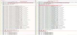

TDA4VE-Q1: OSPI mode sbl boot linux Startup exception
Part Number: TDA4VE-Q1
HW TDA4ECO  SDK8.6
sbl_cust_img_mcu1_0_release.tiimage----->sbl_boot_app_ospi_linux_j721s2_evm_mcu1_0_freertos_TestApp_release.appimage--->atf_optee.appimage ----->tidtb_linux.appimage/tikernelimage_linux.appimage---->rootfs
[    0.000000] Booting Linux on physical CPU 0x0000000000 [0x411fd080]
[    0.000000] Linux version 5.10.162-g76b3e88d56 (jun@jun) (aarch64-none-linux-gnu-gcc (GNU Toolchain for the A-profile Architecture 9.2-2019.12 (arm-9.10)) 9.2.1 20191025, GNU ld (GNU Toolchain for the A-profile Architecture 9.2-2019.12 (arm-9.10)) 2.33.1.20191209) #1 SMP PREEMPT Tue Dec 19 15:15:07 CST 2023
[    0.000000] Machine model: Texas Instruments J721S2 EVM
[    0.000000] earlycon: ns16550a0 at MMIO32 0x0000000002880000 (options '')
[    0.000000] printk: bootconsole [ns16550a0] enabled
[    0.000000] efi: UEFI not found.
[    0.000000] [Firmware Bug]: Kernel image misaligned at boot, please fix your bootloader!

[    0.187826] ------------[ cut here ]------------
[    0.192549] WARNING: CPU: 0 PID: 1 at mm/cma.c:106 cma_init_reserved_areas+0x7c/0x170
[    0.200547] Modules linked in:
[    0.203667] CPU: 0 PID: 1 Comm: swapper/0 Not tainted 5.10.162-g76b3e88d56 #1
[    0.210954] Hardware name: Texas Instruments J721S2 EVM (DT)
[    0.216732] pstate: 80000005 (Nzcv daif -PAN -UAO -TCO BTYPE=--)
boot log.

    The above is the main failing function. Have you made changes to the reserved memory section in the device tree?
    Keerthy
  • SD card mode, Boot in uboot normally,
    Then, converting the dtb Image to an appimage file and bootup it with mcu bootApp in OSPI mode will result in an exception.
  • When I modify dts to the following, the OSPI startup kernel will fail, while the modified SD card startup will not fail
    diff --git a/arch/arm64/boot/dts/ti/k3-j721s2-common-proc-board.dts b/arch/arm64/boot/dts/ti/k3-j721s2-common-proc-board.dts
    index 8730ca7a3..7315ec13b 100644
    --- a/arch/arm64/boot/dts/ti/k3-j721s2-common-proc-board.dts
    +++ b/arch/arm64/boot/dts/ti/k3-j721s2-common-proc-board.dts
    @@ -19,9 +19,17 @@ / {
     	chosen {
     		stdout-path = "serial2:115200n8";
    -		bootargs = "console=ttyS2,115200n8 earlycon=ns16550a,mmio32,0x2880000";
    +		bootargs = "console=ttyS2,115200n8 earlycon=ns16550a,mmio32,0x2880000 root=/dev/mmcblk0p2  rw rootfstype=ext4 rootwait";

    Can you make sure that dtbs are loading correctly when you boot from ospi?
    Just compare the phase where the Linux and dtbs are loaded.
    Also can you try with default SDK and check if ospi boot works well?
    Keerthy
  • Hi.
    I can confirm that it is correct.
    You can also boot using the default one, as using OSPI to boot Linux requires adding k3-j721s2-vision apps. dtbo to k3-j721s2-common proc board.dtb, but there are also exceptions after adding it
  • changed to the following, start normal
    sbl-->boot_app_ospi_linux_j721s2_evm_mcu1_0_freertos_TestApp_release.appimage--->atf_optee.appimage ----->ti_uboot_spl.appimage---->uboot.img---
    So if U-boot is part of the boot flow then boot is working fine. So could you check the log difference with and without U-Boot w.r.t cma regions?
    Keerthy
