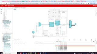

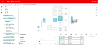

We want to reduce the WKUP_CLKOUT0 clock output to 10 Mhz. We have checked in syscfg tool as shown below. Modifying the PLL2_HSDIV_B value is giving us the expected value of 10 Mhz. How I can adapt the same in code base and build the code to test the same. Kindly let me know the Process and also changing WKUP_CLKOUT0 to 10 MHz will impact other modules?
Also can we use devmem2 { address } [ type [ data ] ] to set the clock to 10 MHz for our initial Testing?

    As per TRM we need to write value "0x00000004" to select PLL2_HSDIV_B and frequency output was 50 Mhz. we need to configure separate register to change the divider value?

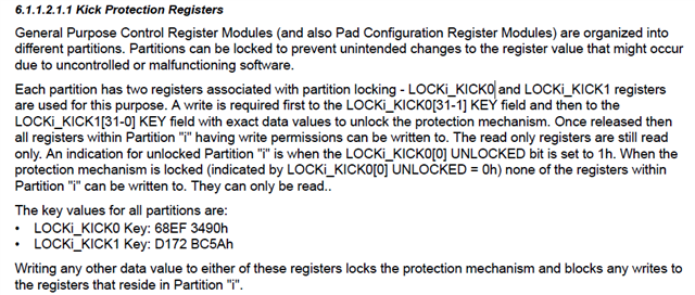

  • To change the frequency of  PLL2_HSDIV9 you will need to first unlock the registers as noted in the TRM:
    The PLL2 Lock registers are:
    pll2_LOCKKEY0     682010h
    pll2_LOCKKEY1     682014h
    You can then write to the require HSDIV value to the pll2_HSDIV_CTRL9 register at address 6820A4h
    Similar process for the CLKOUT_CTRL register.
    First, unlock....
    For the clkout_ctrl register, you must unlock using the following registers:
    LOCK2_KICK0   10 9008h
    LOCK2_KICK1   10 900Ch
    Now you can write 4b100 to the CLKOUT_CTRL_WKUP_CLKOUT_SEL bit field of the  CLKOUT_CTRL register at 43008020h
