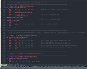

More specific, the R5 cores entered "prefetch exception" state after configuring and activating MPU unit.

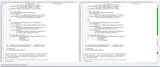

After rereading documentation, and poking around source-code this changeset grabbed my attention:
Left is v09_00, right is v09_01: pdk_jacinto*/packages/ti/csl/arch/r5/startup.c
Line 150, 153 on right side: accessCtrlRegVal is set differently. gMemAttr did not change, so for me it seems quite obvious that existing MPU-Configurations will break.
Could you explain please that change? And why is that not documented?

  • Hi Thomas,
    Thanks for pointing this out. Does it work fine if you revert this change? C and B attribute decides the memory type, so potentially can have effect. Can you please try reverting it?
    Brijesh
  • Hi Brijesh,
    yes. It works fine when I revert that particular change.
    Thomas

        .enable           = 1U,
        .baseAddr         = APP_LOG_MEM_ADDR, // 0xAD000000u,
        .size             = CSL_ARM_R5_MPU_REGION_SIZE_256KB,
        .subRegionEnable  = CSL_ARM_R5_MPU_SUB_REGION_ENABLE_ALL,
        .exeNeverControl  = 0U,
        .accessPermission = CSL_ARM_R5_ACC_PERM_PRIV_USR_RD_WR,
        .shareable        = 0U,
        .cacheable        = (uint32_t)FALSE,
        .cachePolicy      = 0U,
        .memAttr          = CSL_ARM_R5_MEM_ATTR_CACHED_WT_NO_WA,
    Do you notice any inconstancy here?

    yes. The prefetch abort issue happens exactly when line 160 of pdk_jacinto_09_01_00_22/packages/ti/csl/arch/r5/src/startup/r5_startup.asm gets executed.
    From my point of view, following happens in summary:
    1. R5 out of reset.
    2. MPU gets configured
    2.1 MPU gets disabled
    2.2 MPU Config Array gets applied
    2.3 MPU gets enabled
    At step 2.3, when armR5MpuEnable_00 is executed, there is first a Data Synchronisation Barrier (DSB), then SCTLR gets modified (enable MPU), then Instruction Synchronisation Barrier (ISB).
    After ISB, the R5 jumps to prefetch abort exception state.
