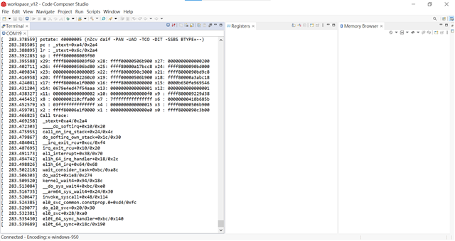

  • Hi James,
    How can we get the full register dump by CCS?
    We are trying to boot an SDK image using UART console but stuck in somewhere.
    As you can see, the register and memory browser are empty.
    Or should I just paste the UART log in here?

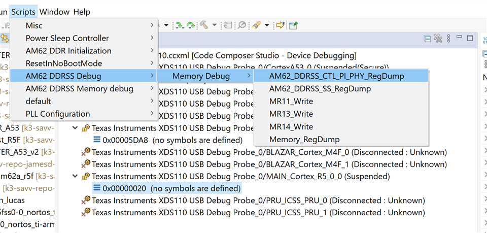

  • To get a full register dump by CCS:
    -create a new Target Configuration and choose the appropriate board in "Board or Device"
    -after powering up the board, connect to R5 core and run AM62 DDRSS Debug->Memory Debug->AM62_DDRSS_CTL_PI_PHY_RegDump
    This should output all relevant registers to the console window.  Post these here and i can help parse them for you
    As for the frequency sets, F0 is the boot frequency, and F1/F2 are the operating frequencies.  Currently, our SDKs only use one operating frequency F2.
    james

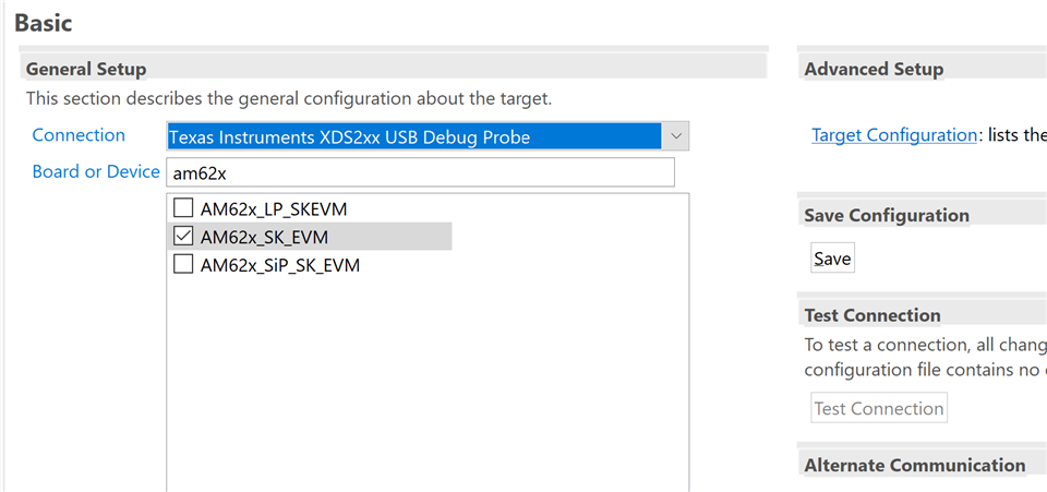

  • Hi James,
    We cannot find the appropriate board in "Board or Device" or "Connection".
    Here're the boards on hand:
    SK-AM62A-LP
    SK-AM62B-P1
    SK-AM64B
    So, what F0/1/2 frequencies are?
    Are they 50/800/800 MHz in below pic (SysConfig LP4)?
    Then how about DDR4?
    Thanks.
    Maurice
  • For SK-AM64B, choose AM64x_SK_EVM
    For SK-AM62B-P1, choose AM62x_SK_EVM
    For SK-AM62A-LP, choose AM62A_SK_EVM
    AM64x and AM62x will run at 800MHz, AM62Ax will run at 1600MHz.  Only FSP2 is used, FSP1 is not used, FSP0 boot frequency will always be 50MHz
    James

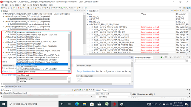

  • Hi James,
    Thanks for the reply.
    I can see device in the list, but still don't know which connection I shoule select.
    As below pic.
    Also, does "connect to R5 core" mean to connect UART with the 4th USB serial port?
    And where can I run "AM62 DDRSS Debug->Memory Debug->AM62_DDRSS_CTL_PI_PHY_RegDump" in CCS window?
    Thanks.
    Maurice

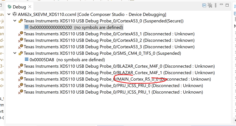

  • Maurice, what type of JTAG pod do you have?  That's what you would choose in the device list  For example, here i'm using the TI XDS200 probe:
    You will see cortex_R5 as one of the cores to connect to.
    Once connected, you can run the script in CCS.
    James
