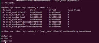

=> mtdparts
device spi-nand0 <spi-nand0>, # parts = 7
#: name size offset mask_flags
0: ospi_nand.tiboot3 0x00080000 0x00000000 0
1: ospi_nand.tispl 0x00200000 0x00080000 0
2: ospi_nand.u-boot 0x00400000 0x00280000 0
3: ospi_nand.env 0x00040000 0x00680000 0
4: ospi_nand.env.backup0x00040000 0x006c0000 0
5: ospi_nand.rootfs 0x05fc0000 0x02000000 0
6: ospi_nand.phypattern0x00040000 0x07fc0000 0
active partition: spi-nand0,0 - (ospi_nand.tiboot3) 0x00080000 @ 0x00000000
defaults:
mtdids :
mtdparts:

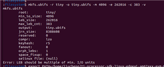

    1.create ubi image
    I use AM62a provide filesystem tisdk-edgeai-image-am62axx-evm.tar.xz as my base rootfs. I first unzip it and use the two commands below to make a ubi image.
    mkfs.ubifs -r tiny -o tiny.ubifs -m 4096 -e 253952 -c 383 -v
    ubinize -o tiny.ubi -m 4096 -s 4096 -p 256KiB ubinize.cfg -v
    in the refer link, you used command blow.
    - "mkfs.ubifs -r sdk-tiny-fs -o am6-sdk-tiny-fs.ubifs -m 16 -e 262016 -c 143 -v"
    - "ubinize -o am6-sdk-tiny-fs.ubi -m 16 -s 16 -p 256KiB ubinize.cfg -v"
    I changed -m 16 to 4096 and -c 143 to 383 as the spi_nand mtdinfo shows in my board.
    mtd5
    Type: nand
    Eraseblock size: 262144 bytes, 256.0 KiB
    Amount of eraseblocks: 383 (100401152 bytes, 95.7 MiB)
    Minimum input/output unit size: 4096 bytes
    Sub-page size: 4096 bytes
    OOB size: 128 bytes
    Character device major/minor: 90:10
    Bad blocks are allowed: true
    Device is writable: true
    I also changed -e 262016 to 253952 because of the error "Error: LEB should be multiple of min. I/O units"
    after that I create a ubi image.

    It shows
    [ 3.573612] VFS: Cannot open root device "ubi0:rootfs" or unknown-block(0,0): error -19
    [ end Kernel panic - not syncing: VFS: Unable to mount root fs on unknown-block (0,0)].
    In uboot ,when I use ubifsmount , it is error.
    U-Boot 2023.04-gbd74e615a6 (Sep 06 2023 - 10:09:25 +0000)
    SoC:   AM62AX SR1.0 HS-FS
    Model: Texas Instruments AM62A7 SK
    DRAM:  2 GiB (effective 4 GiB)
    Core:  57 devices, 27 uclasses, devicetree: separate
    MMC:   mmc@fa10000: 0, mmc@fa00000: 1
    Loading Environment from nowhere... OK
    In:    serial@2800000
    Out:   serial@2800000
    Err:   serial@2800000
    Net:   eth0: ethernet@8000000port@1
    Hit any key to stop autoboot:  0
    => mtd list
    List of MTD devices:
    * spi-nand0
      - device: flash@0
      - parent: spi@fc40000
      - driver: spi_nand
      - path: /bus@f0000/bus@fc00000/spi@fc40000/flash@0
      - type: NAND flash
      - block size: 0x40000 bytes
      - min I/O: 0x1000 bytes
      - OOB size: 128 bytes
      - OOB available: 80 bytes
      - 0x000000000000-0x000008000000 : "spi-nand0"
              - 0x000000000000-0x000000080000 : "ospi_nand.tiboot3"
              - 0x000000080000-0x000000280000 : "ospi_nand.tispl"
              - 0x000000280000-0x000000680000 : "ospi_nand.u-boot"
              - 0x000000680000-0x0000006c0000 : "ospi_nand.env"
              - 0x0000006c0000-0x000000700000 : "ospi_nand.env.backup"
              - 0x000002000000-0x000007fc0000 : "ospi_nand.rootfs"
              - 0x000007fc0000-0x000008000000 : "ospi_nand.phypattern"
    => ubi part ospi_nand.rootfs
    ubi0: attaching mtd6
    ubi0: scanning is finished
    ubi0: attached mtd6 (name "ospi_nand.rootfs", size 95 MiB)
    ubi0: PEB size: 262144 bytes (256 KiB), LEB size: 253952 bytes
    ubi0: min./max. I/O unit sizes: 4096/4096, sub-page size 4096
    ubi0: VID header offset: 4096 (aligned 4096), data offset: 8192
    ubi0: good PEBs: 383, bad PEBs: 0, corrupted PEBs: 0
    ubi0: user volume: 1, internal volumes: 1, max. volumes count: 128
    ubi0: max/mean erase counter: 1/0, WL threshold: 4096, image sequence number: 767762267
    ubi0: available PEBs: 0, total reserved PEBs: 383, PEBs reserved for bad PEB handling: 10
    => ubi part
    Device 0: ubi0, MTD partition ospi_nand.rootfs
    => ubifsmount ospi_nand.rootfs
    UBIFS error (pid: 1): cannot open "ospi_nand.rootfs", error -22
    Error reading superblock on volume 'ospi_nand.rootfs' errno=-22!
    are the 3 steps above ok or not?
    how can I solve the problems above?
    Looking forward to your reply!
  • Hello Cheng,
    Thanks for the update.
    I've not got chance trying out ubi/ubifs on AM62x SPI-NAND yet so I'm not able to tell the exact issue you have.
    In the referenced e2e,
    e2e.ti.com/.../3769546
    3. Flash the generated UBI rootfs file "am6-sdk-tiny-fs.ubi" to OSPI in kernel from SD card boot as an example:
    I used "ubiformat /dev/mtd7 -f am6-sdk-tiny-fs.ubi" at kernel to flash/format the UBI rootfs file to MTD7 (ospi.rootfs).
    Refer to the attached log file "am6_ubiformat_ospi.txt" for more details.
    I also attached another log file "am6_ubiattach_ospi.txt" to show attaching MDT7 (ospi.rootfs) for testing.
    Have we checked attaching mtd rootfs @kernel as shown in "am6_ubiattach_ospi.txt"?
    This is to check if ubi/ubifs is created ok, and can be attached @kernel.
    -Hong
  • Hello Hong,
    Thanks for your direction.
    This problem has been solved, the root cause of
    "[ 3.573612] VFS: Cannot open root device "ubi0:rootfs" or unknown-block(0,0): error -19"
    is kernel don't insert ubi drivers.
    In the current SDK version, the ubi driver is compiled into ubi.ko as a module.
    I modified the kernel compilation configuration to integrate the ubi driver into Image, and this issue was solved.
  • Hello Cheng,
    It is very good to know full Linux boot works on SPI-NAND on your setup.
    Thanks for sharing your findings on the kernel ubi driver is currently built as an module.
    -Hong
