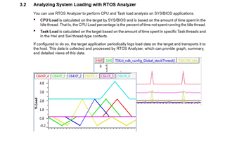

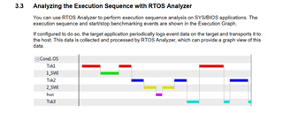

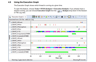

Can we do this with CCS? Sometimes we need to debug with CCS, or generate images directly from data, rather than just log
Like the images below
FreeRTOS support is there for Lauterbach (along with SYS/BIOS, Linux, QNX, ...).
For CCS, I think only SYSBIOS has this. You can get load and resource reports with LB.
Would you be fine with checking the same with Lauterbach or are you using only CCS?
Meanwhile let me check with CCS team internally.
Nikhil
This is correct.
