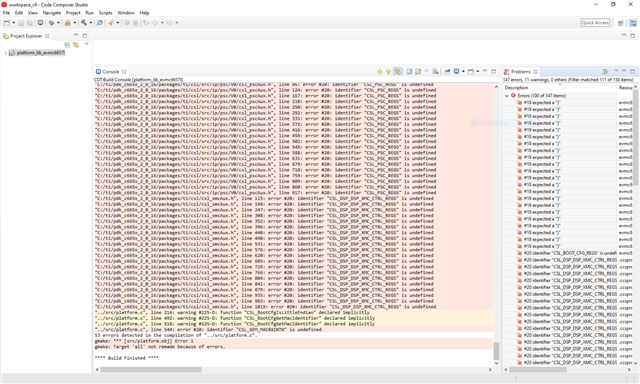

  • Shankari G, thank you for your response.  I tried to follow the recommended instructions but do not yet have success.  Please see detailed description of steps I took and associated results below.  Please recommend next steps.  Thank you.
    I followed the recommended example at https://e2e.ti.com/support/processors-group/processors/f/processors-forum/1071275/faq-tms320c6657-how-to-build-and-run-the-platform-test-on-c6657-evm  Note that the recommended example is for the c667x, not the c6657.  I replicated the steps from the recommended example below, with notes of what I did at each step and the associated results marked by my initials.

    I apparently have a different version of CCS (7.3.00019) than the version shown in the video.  My version has a different menu structure than shown in the video, so I cannot follow the recommended steps.
    What I did instead:
    • Open CCS
    • From the list of menu items at the top of CCS, select ‘Project’.
    • There is no ‘Import’ option under ‘Project’.
    • From the list of menu items at the top of CCS, select ‘File’ / ‘Import…’
    • In the ‘Import’ dialog box:
    • In the ‘Select an import wizard’ list, there are a lot of options. Hard to know which to choose!
    • Expanded ‘C/C++’ and selected ‘CCS Projects’ (apparent closest match to video)
    • Click ‘Next >’
    • In ‘Import CCS Eclipse Projects’ dialog box:
    • Check selected ‘Select search-directory’
    • Click on the ‘Browse’ button
    • Browse to ‘c:\ti\pdk_c665x_2_0_7\packages\ti\platform\evmc6657l\platform_lib’
    • ‘platform_lib_evmc6657l’ appears in the ‘Discovered projects:’ list
    • Click ‘Finish’
    • In CCS, in the ‘Project Explorer’ tab:
    • Select ‘platform_lib_evmc6657l’
    • Click the ‘hammer’ icon to build

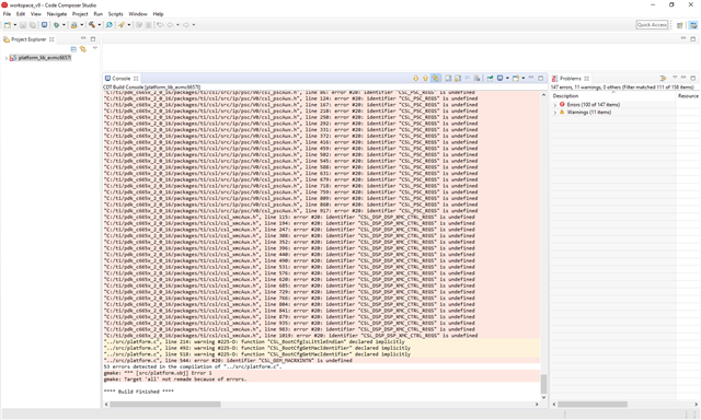

    • Receive many, many errors in the ‘Console’ tab, so many that the beginning of the error list is lost.  See the list of errors that I could recover, included below:

    "C:/ti/pdk_c665x_2_0_7/packages/ti/csl/csl_xmcAux.h", line 308: error #20: identifier "CSL_DSP_DSP_XMC_CTRL_REGS" is undefined
    "C:/ti/pdk_c665x_2_0_7/packages/ti/csl/csl_xmcAux.h", line 352: error #20: identifier "CSL_DSP_DSP_XMC_CTRL_REGS" is undefined
    "C:/ti/pdk_c665x_2_0_7/packages/ti/csl/csl_xmcAux.h", line 396: error #20: identifier "CSL_DSP_DSP_XMC_CTRL_REGS" is undefined
    "C:/ti/pdk_c665x_2_0_7/packages/ti/csl/csl_xmcAux.h", line 440: error #20: identifier "CSL_DSP_DSP_XMC_CTRL_REGS" is undefined
    "C:/ti/pdk_c665x_2_0_7/packages/ti/csl/csl_xmcAux.h", line 490: error #20: identifier "CSL_DSP_DSP_XMC_CTRL_REGS" is undefined
    "C:/ti/pdk_c665x_2_0_7/packages/ti/csl/csl_xmcAux.h", line 531: error #20: identifier "CSL_DSP_DSP_XMC_CTRL_REGS" is undefined
    "C:/ti/pdk_c665x_2_0_7/packages/ti/csl/csl_xmcAux.h", line 576: error #20: identifier "CSL_DSP_DSP_XMC_CTRL_REGS" is undefined
    "C:/ti/pdk_c665x_2_0_7/packages/ti/csl/csl_xmcAux.h", line 620: error #20: identifier "CSL_DSP_DSP_XMC_CTRL_REGS" is undefined
    "C:/ti/pdk_c665x_2_0_7/packages/ti/csl/csl_xmcAux.h", line 685: error #20: identifier "CSL_DSP_DSP_XMC_CTRL_REGS" is undefined
    "C:/ti/pdk_c665x_2_0_7/packages/ti/csl/csl_xmcAux.h", line 729: error #20: identifier "CSL_DSP_DSP_XMC_CTRL_REGS" is undefined
    "C:/ti/pdk_c665x_2_0_7/packages/ti/csl/csl_xmcAux.h", line 766: error #20: identifier "CSL_DSP_DSP_XMC_CTRL_REGS" is undefined
    "C:/ti/pdk_c665x_2_0_7/packages/ti/csl/csl_xmcAux.h", line 804: error #20: identifier "CSL_DSP_DSP_XMC_CTRL_REGS" is undefined
    "C:/ti/pdk_c665x_2_0_7/packages/ti/csl/csl_xmcAux.h", line 841: error #20: identifier "CSL_DSP_DSP_XMC_CTRL_REGS" is undefined
    "C:/ti/pdk_c665x_2_0_7/packages/ti/csl/csl_xmcAux.h", line 879: error #20: identifier "CSL_DSP_DSP_XMC_CTRL_REGS" is undefined
    "C:/ti/pdk_c665x_2_0_7/packages/ti/csl/csl_xmcAux.h", line 935: error #20: identifier "CSL_DSP_DSP_XMC_CTRL_REGS" is undefined
    "C:/ti/pdk_c665x_2_0_7/packages/ti/csl/csl_xmcAux.h", line 983: error #20: identifier "CSL_DSP_DSP_XMC_CTRL_REGS" is undefined
    "C:/ti/pdk_c665x_2_0_7/packages/ti/csl/csl_xmcAux.h", line 1019: error #20: identifier "CSL_DSP_DSP_XMC_CTRL_REGS" is undefined
    52 errors detected in the compilation of "../src/evmc665x_nor.c".
    gmake: *** [src/evmc665x_nor.obj] Error 1
    'Building file: ../src/evmc665x_phy.c'
    'Invoking: C6000 Compiler'
    "C:/ti/ti-cgt-c6000_8.1.3/bin/cl6x" -mv6600 --abi=eabi -g --include_path="C:/ti/ti-cgt-c6000_8.1.3/include" --include_path="C:/ti/pdk_c665x_2_0_7/packages" --include_path="C:/ti/pdk_c665x_2_0_7/packages/ti/csl" --include_path="C:/ti/pdk_c665x_2_0_7/packages/ti/platform/evmc6657l/platform_lib/include" --include_path="C:/ti/pdk_c665x_2_0_7/packages/ti/platform" --display_error_number --diag_warning=225 --preproc_with_compile --preproc_dependency="src/evmc665x_phy.d_raw" --obj_directory="src" "../src/evmc665x_phy.c"
    >> Compilation failure
    src/subdir_rules.mk:58: recipe for target 'src/evmc665x_phy.obj' failed
    "C:/ti/pdk_c665x_2_0_7/packages/ti/csl/csl_semAux.h", line 89: error #20: identifier "CSL_SEMAPHORE_REGS" is undefined
    "C:/ti/pdk_c665x_2_0_7/packages/ti/csl/csl_semAux.h", line 130: error #20: identifier "CSL_SEMAPHORE_REGS" is undefined
    "C:/ti/pdk_c665x_2_0_7/packages/ti/csl/csl_semAux.h", line 168: error #20: identifier "CSL_SEMAPHORE_REGS" is undefined
    "C:/ti/pdk_c665x_2_0_7/packages/ti/csl/csl_semAux.h", line 209: error #20: identifier "CSL_SEMAPHORE_REGS" is undefined
    "C:/ti/pdk_c665x_2_0_7/packages/ti/csl/csl_semAux.h", line 252: error #20: identifier "CSL_SEMAPHORE_REGS" is undefined
    "C:/ti/pdk_c665x_2_0_7/packages/ti/csl/csl_semAux.h", line 293: error #20: identifier "CSL_SEMAPHORE_REGS" is undefined
    "C:/ti/pdk_c665x_2_0_7/packages/ti/csl/csl_semAux.h", line 335: error #20: identifier "CSL_SEMAPHORE_REGS" is undefined
    "C:/ti/pdk_c665x_2_0_7/packages/ti/csl/csl_semAux.h", line 384: error #20: identifier "CSL_SEMAPHORE_REGS" is undefined
    "C:/ti/pdk_c665x_2_0_7/packages/ti/csl/csl_semAux.h", line 425: error #20: identifier "CSL_SEMAPHORE_REGS" is undefined
    "C:/ti/pdk_c665x_2_0_7/packages/ti/csl/csl_semAux.h", line 469: error #20: identifier "CSL_SEMAPHORE_REGS" is undefined
    "C:/ti/pdk_c665x_2_0_7/packages/ti/csl/csl_semAux.h", line 517: error #20: identifier "CSL_SEMAPHORE_REGS" is undefined
    "C:/ti/pdk_c665x_2_0_7/packages/ti/csl/csl_semAux.h", line 568: error #20: identifier "CSL_SEMAPHORE_REGS" is undefined
    "C:/ti/pdk_c665x_2_0_7/packages/ti/csl/src/ip/psc/V0/csl_pscAux.h", line 86: error #20: identifier "CSL_PSC_REGS" is undefined
    "C:/ti/pdk_c665x_2_0_7/packages/ti/csl/src/ip/psc/V0/csl_pscAux.h", line 124: error #20: identifier "CSL_PSC_REGS" is undefined
    "C:/ti/pdk_c665x_2_0_7/packages/ti/csl/src/ip/psc/V0/csl_pscAux.h", line 167: error #20: identifier "CSL_PSC_REGS" is undefined
    "C:/ti/pdk_c665x_2_0_7/packages/ti/csl/src/ip/psc/V0/csl_pscAux.h", line 210: error #20: identifier "CSL_PSC_REGS" is undefined
    "C:/ti/pdk_c665x_2_0_7/packages/ti/csl/src/ip/psc/V0/csl_pscAux.h", line 250: error #20: identifier "CSL_PSC_REGS" is undefined
    "C:/ti/pdk_c665x_2_0_7/packages/ti/csl/src/ip/psc/V0/csl_pscAux.h", line 292: error #20: identifier "CSL_PSC_REGS" is undefined
    "C:/ti/pdk_c665x_2_0_7/packages/ti/csl/src/ip/psc/V0/csl_pscAux.h", line 331: error #20: identifier "CSL_PSC_REGS" is undefined
    "C:/ti/pdk_c665x_2_0_7/packages/ti/csl/src/ip/psc/V0/csl_pscAux.h", line 372: error #20: identifier "CSL_PSC_REGS" is undefined
    "C:/ti/pdk_c665x_2_0_7/packages/ti/csl/src/ip/psc/V0/csl_pscAux.h", line 416: error #20: identifier "CSL_PSC_REGS" is undefined
    "C:/ti/pdk_c665x_2_0_7/packages/ti/csl/src/ip/psc/V0/csl_pscAux.h", line 459: error #20: identifier "CSL_PSC_REGS" is undefined
    "C:/ti/pdk_c665x_2_0_7/packages/ti/csl/src/ip/psc/V0/csl_pscAux.h", line 502: error #20: identifier "CSL_PSC_REGS" is undefined
    "C:/ti/pdk_c665x_2_0_7/packages/ti/csl/src/ip/psc/V0/csl_pscAux.h", line 545: error #20: identifier "CSL_PSC_REGS" is undefined
    "C:/ti/pdk_c665x_2_0_7/packages/ti/csl/src/ip/psc/V0/csl_pscAux.h", line 588: error #20: identifier "CSL_PSC_REGS" is undefined
    "C:/ti/pdk_c665x_2_0_7/packages/ti/csl/src/ip/psc/V0/csl_pscAux.h", line 631: error #20: identifier "CSL_PSC_REGS" is undefined
    "C:/ti/pdk_c665x_2_0_7/packages/ti/csl/src/ip/psc/V0/csl_pscAux.h", line 679: error #20: identifier "CSL_PSC_REGS" is undefined
    "C:/ti/pdk_c665x_2_0_7/packages/ti/csl/src/ip/psc/V0/csl_pscAux.h", line 718: error #20: identifier "CSL_PSC_REGS" is undefined
    "C:/ti/pdk_c665x_2_0_7/packages/ti/csl/src/ip/psc/V0/csl_pscAux.h", line 759: error #20: identifier "CSL_PSC_REGS" is undefined
    "C:/ti/pdk_c665x_2_0_7/packages/ti/csl/src/ip/psc/V0/csl_pscAux.h", line 809: error #20: identifier "CSL_PSC_REGS" is undefined
    "C:/ti/pdk_c665x_2_0_7/packages/ti/csl/src/ip/psc/V0/csl_pscAux.h", line 860: error #20: identifier "CSL_PSC_REGS" is undefined
    "C:/ti/pdk_c665x_2_0_7/packages/ti/csl/src/ip/psc/V0/csl_pscAux.h", line 917: error #20: identifier "CSL_PSC_REGS" is undefined
    "C:/ti/pdk_c665x_2_0_7/packages/ti/csl/csl_xmcAux.h", line 115: error #20: identifier "CSL_DSP_DSP_XMC_CTRL_REGS" is undefined
    "C:/ti/pdk_c665x_2_0_7/packages/ti/csl/csl_xmcAux.h", line 194: error #20: identifier "CSL_DSP_DSP_XMC_CTRL_REGS" is undefined
    "C:/ti/pdk_c665x_2_0_7/packages/ti/csl/csl_xmcAux.h", line 247: error #20: identifier "CSL_DSP_DSP_XMC_CTRL_REGS" is undefined
    "../src/evmc665x_phy.c", line 56: warning #225-D: function "CSL_BootCfgUnlockKicker" declared implicitly
    "../src/evmc665x_phy.c", line 60: warning #225-D: function "CSL_BootCfgSetSGMIIConfigPLL" declared implicitly
    "../src/evmc665x_phy.c", line 80: warning #225-D: function "CSL_BootCfgSetSGMIIRxConfig" declared implicitly
    "../src/evmc665x_phy.c", line 97: warning #225-D: function "CSL_BootCfgSetSGMIITxConfig" declared implicitly
    "../src/evmc665x_phy.c", line 109: error #20: identifier "CSL_BOOT_CFG_REGS" is undefined
    53 errors detected in the compilation of "../src/evmc665x_phy.c".
    gmake: *** [src/evmc665x_phy.obj] Error 1
    'Building file: ../src/evmc665x_spi.c'
    "C:/ti/ti-cgt-c6000_8.1.3/bin/cl6x" -mv6600 --abi=eabi -g --include_path="C:/ti/ti-cgt-c6000_8.1.3/include" --include_path="C:/ti/pdk_c665x_2_0_7/packages" --include_path="C:/ti/pdk_c665x_2_0_7/packages/ti/csl" --include_path="C:/ti/pdk_c665x_2_0_7/packages/ti/platform/evmc6657l/platform_lib/include" --include_path="C:/ti/pdk_c665x_2_0_7/packages/ti/platform" --display_error_number --diag_warning=225 --preproc_with_compile --preproc_dependency="src/evmc665x_spi.d_raw" --obj_directory="src" "../src/evmc665x_spi.c"
    >> Compilation failure
    src/subdir_rules.mk:65: recipe for target 'src/evmc665x_spi.obj' failed
    "../src/evmc665x_spi.c", line 86: error #20: identifier "CSL_SPI_REGS" is undefined
    "../src/evmc665x_spi.c", line 190: error #20: identifier "CSL_SPI_REGS" is undefined
    "../src/evmc665x_spi.c", line 225: error #20: identifier "CSL_SPI_REGS" is undefined
    "../src/evmc665x_spi.c", line 462: error #20: identifier "CSL_SPI_REGS" is undefined
    "../src/evmc665x_spi.c", line 552: error #20: identifier "CSL_SPI_REGS" is undefined
    57 errors detected in the compilation of "../src/evmc665x_spi.c".
    gmake: *** [src/evmc665x_spi.obj] Error 1
    'Building file: ../src/evmc665x_uart.c'
    "C:/ti/ti-cgt-c6000_8.1.3/bin/cl6x" -mv6600 --abi=eabi -g --include_path="C:/ti/ti-cgt-c6000_8.1.3/include" --include_path="C:/ti/pdk_c665x_2_0_7/packages" --include_path="C:/ti/pdk_c665x_2_0_7/packages/ti/csl" --include_path="C:/ti/pdk_c665x_2_0_7/packages/ti/platform/evmc6657l/platform_lib/include" --include_path="C:/ti/pdk_c665x_2_0_7/packages/ti/platform" --display_error_number --diag_warning=225 --preproc_with_compile --preproc_dependency="src/evmc665x_uart.d_raw" --obj_directory="src" "../src/evmc665x_uart.c"
    >> Compilation failure
    src/subdir_rules.mk:72: recipe for target 'src/evmc665x_uart.obj' failed
    "../src/evmc665x_uart.c", line 66: error #20: identifier "CSL_UART_REGS" is undefined
    "../src/evmc665x_uart.c", line 67: error #20: identifier "CSL_UART_B_REGS" is undefined
    "../src/evmc665x_uart.c", line 197: error #20: identifier "CSL_UART_REGS" is undefined
    "../src/evmc665x_uart.c", line 223: error #20: identifier "CSL_UART_B_REGS" is undefined
    "../src/evmc665x_uart.c", line 248: error #20: identifier "CSL_UART_REGS" is undefined
    "../src/evmc665x_uart.c", line 273: error #20: identifier "CSL_UART_B_REGS" is undefined
    "../src/evmc665x_uart.c", line 293: error #20: identifier "CSL_UART_REGS" is undefined
    "../src/evmc665x_uart.c", line 310: error #20: identifier "CSL_UART_B_REGS" is undefined
    "../src/evmc665x_uart.c", line 329: error #20: identifier "CSL_UART_REGS" is undefined
    "../src/evmc665x_uart.c", line 350: error #20: identifier "CSL_UART_B_REGS" is undefined
    "../src/evmc665x_uart.c", line 372: error #20: identifier "CSL_UART_REGS" is undefined
    "../src/evmc665x_uart.c", line 394: error #20: identifier "CSL_UART_B_REGS" is undefined
    64 errors detected in the compilation of "../src/evmc665x_uart.c".
    gmake: *** [src/evmc665x_uart.obj] Error 1
    'Building file: ../src/platform.c'
    "C:/ti/ti-cgt-c6000_8.1.3/bin/cl6x" -mv6600 --abi=eabi -g --include_path="C:/ti/ti-cgt-c6000_8.1.3/include" --include_path="C:/ti/pdk_c665x_2_0_7/packages" --include_path="C:/ti/pdk_c665x_2_0_7/packages/ti/csl" --include_path="C:/ti/pdk_c665x_2_0_7/packages/ti/platform/evmc6657l/platform_lib/include" --include_path="C:/ti/pdk_c665x_2_0_7/packages/ti/platform" --display_error_number --diag_warning=225 --preproc_with_compile --preproc_dependency="src/platform.d_raw" --obj_directory="src" "../src/platform.c"
    >> Compilation failure
    src/subdir_rules.mk:79: recipe for target 'src/platform.obj' failed
    "../src/platform.c", line 214: warning #225-D: function "CSL_BootCfgIsLittleEndian" declared implicitly
    "../src/platform.c", line 492: warning #225-D: function "CSL_BootCfgGetMacIdentifier" declared implicitly
    "../src/platform.c", line 518: warning #225-D: function "CSL_BootCfgGetMacIdentifier" declared implicitly
    "../src/platform.c", line 544: error #20: identifier "CSL_GEM_MACRXINTN" is undefined
    53 errors detected in the compilation of "../src/platform.c".
    gmake: *** [src/platform.obj] Error 1
    gmake: Target 'all' not remade because of errors.
    **** Build Finished ****

    Point number 1: You should use CCS 9.3
    Point number 2: Please focus on the "Linker Warnings"
    Point number 3: - In CCS, have you checked the register values-getting changed for those particular GPIO pin?
    Let me also post how to check the register values in CCS.

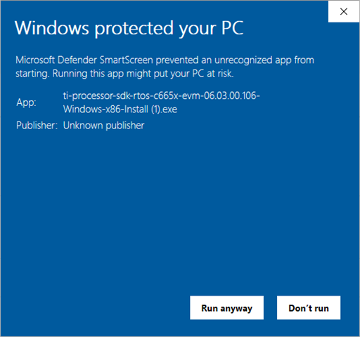

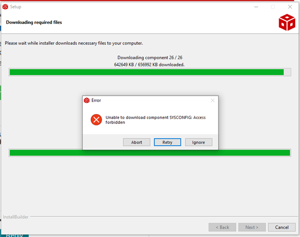

    I decided to try a different approach.  I can install whatever I want on my home PC, so I took the following steps on my home PC, which does not have the limitations of the secure network I mentioned earlier.
    1) I downloaded and installed 'ti-processor-sdk-rtos-c665x-evm-06.03.00.106-Windows-x86-Install.exe' in 'c:\ti\'
    2) I turned off the anti-virus software on my PC.
    3) I downloaded and installed 'CCS9.3.0.00012_win64' in 'c:\ti\'
    4) Per your earlier guidance, I attempted to follow the instructions on this website: [FAQ] TMS320C6657: How to build and run the platform test on C6657 EVM ? - Processors forum - Processors - TI E2E support forums
    5) I went to the link in step 4.  Step 3 of this page says 'Rebuild the PDK and SDK which in turn will build all the necessary CSL library components etc. Follow the steps given below.'

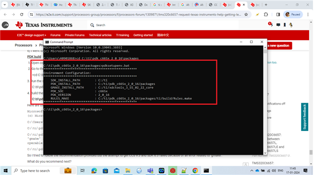

  • Kevin,
    When you execute this command, What is the details it shows on the screen ?
    C:\ti\pdk_c665x_2_0_16\packages>pdksetupenv.bat
    We should get something like below, to make sure the environmental setup is ready for building the PDK and SDK.
    Post your screenshot after you run the "pdksetupenv.bat"

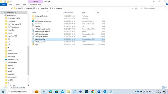

  • I am posting a screen shot as requested.  As I noted previously, 'pdksetupenv.bat' file does nothing.  I investigated further and determined that 'pdksetupenv.bat' is an empty file.  Please advise.
    Also, lack of progress in getting TI embedded systems to work is getting the attention of management.  Can I get a phone number for a Texas Instruments field applications engineer located in my area, Western Pennsylvania so that I can work more interactively? Alternately, could I do a Zoom call with someone at TI to help me work through installing Code Composer Studio?  Thanks.
  • Kevin,
    pdksetupenv.bat is a 4KB file.
    The installation of processor SDK 6.3 is not proper in your machine. Reinstall it.

  • Per your recommendation, I am attempting to reinstall SDK 6.3. For TI's awareness, Windows 10 thinks SDK 6.3 is a virus.  By contrast, I was able to install the Xilinx Vivado and Vitis development tool suites with no comparable issues.
  • I turned off all Windows 10 virus protection features and firewall protection features (prior to installing SDK 6.3).  Just now I tried to install CCS 9.3 using the online installer:
    I got the following error message:
    Will try again using the offline installer:

    I was able to get past the step of invoking 'pdksetupenv.bat':

    When I tried to build 'platform_lib_evmc6657l' in CCS, I got a bunch of errors. The full list of errors is attached in the file '2024-01-17_attempt_to_build_platform_lib_evmc6657l_in_CCS.txt':
    2024-01-17_attempt_to_rebuild_PDK_and_SDK.txt
    Here is a screen capture of these errors as shown in the CCS console:
    Please recommend next steps.  Thanks.
    Kevin,
    Around the years 2014 / 2015, processor SDK 6.3 was developed and released.... At that period people were using Windows 7 and 8.
    Likely, the processor SDK was installed and tested on Windows 7 /8 .
    Windows 10 was not released, by that time... I hope this clarifies your question.
    PLEASE NOTE----> EVEN IN YOUR SCREENSHOT, WINDOWS 10 SAYS -----> IT IS AN UNRECOGNIZED APP
    WHERE DOES IT SAY IT IS A VIRUS??? GETTING SURPRISED BY YOUR COMMENTS !!!

    I was unable to Import and rebuild the "Platform-Lib" CCS project located at "C:\ti\pdk_c665x_2_0_16\packages\ti\platform\evmc6657l\platform_lib".
    Here is a screen capture of the results from CCS:
    The full contents of the CCS CDT Build Console are included in this text file:
    2024-01-18_attempt_to_build_platform_lib_evmc6657l_in_CCS.txt
    Once again, please recommend next steps.  Thanks.

  • Using the guidance you provided above, I was able to resolve the CSL errors in Platform Test Example in TI-RTOS SDK.
    However, I also got the 'cerrno' error you mentioned.  I followed the steps in the 'How to resolve cerrno in Platform Test Example in TI-RTOS SDK' FAQ URL but they did not resolve this error for me. Please see details below.
    Here is the 'Properties for platform_test_evmc6657l' dialog box as shown in the video in the FAQ URL:
    Here are the contents of the same dialog box in my setup after I followed the steps in the video.
    Here is a screen shot that shows I am still getting an error related to 'cerrno'.  The example in the FAQ URL (fatal error #5) is different from the error that I am getting (fatal error #1965).
