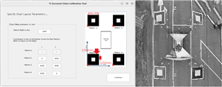

At present, we copy the LENS.bin, CALMAT.bin, and CHARTPOS.bin converted by 3d_calibration_tool (/vision_apps/tools/3d_calibration_tool) to app_srv_camera (/vision_apps/apps/srv_demos/app_srv_camera) for execution. Observing the screen during execution, I found two large black spots on the rear of the car. It was definitely the partial shadow of the license plate on the back of the car. I would like to ask if there is any way to improve this display problem. In addition to physically adjusting the installation angle of the lens, for example, can the values ​​​​in CALMAT.BIN, CHARTPOS.BIN, and LENS.BIN be adjusted so that the partial shadow of the license plate is not displayed? Or You can adjust the radius that the fisheye lens can display, etc…. grateful!!

    The poor output quality can be due to multiple reasons. First of all, you need to check your camera (intrinsic) parameters are accurate enough. I see the output images have large distortion in the left and right sides. The line in the left side is not even straight, which may come from inaccurate camera parameters.
    In the last bird's eye view image, two rear charts are completely from the rear camera. It is better to adjust cameras' poses or charts' position so that a chart is reconstructed from two cameras. (i.e. the stitching line goes though the center (or close to center) of a chart.

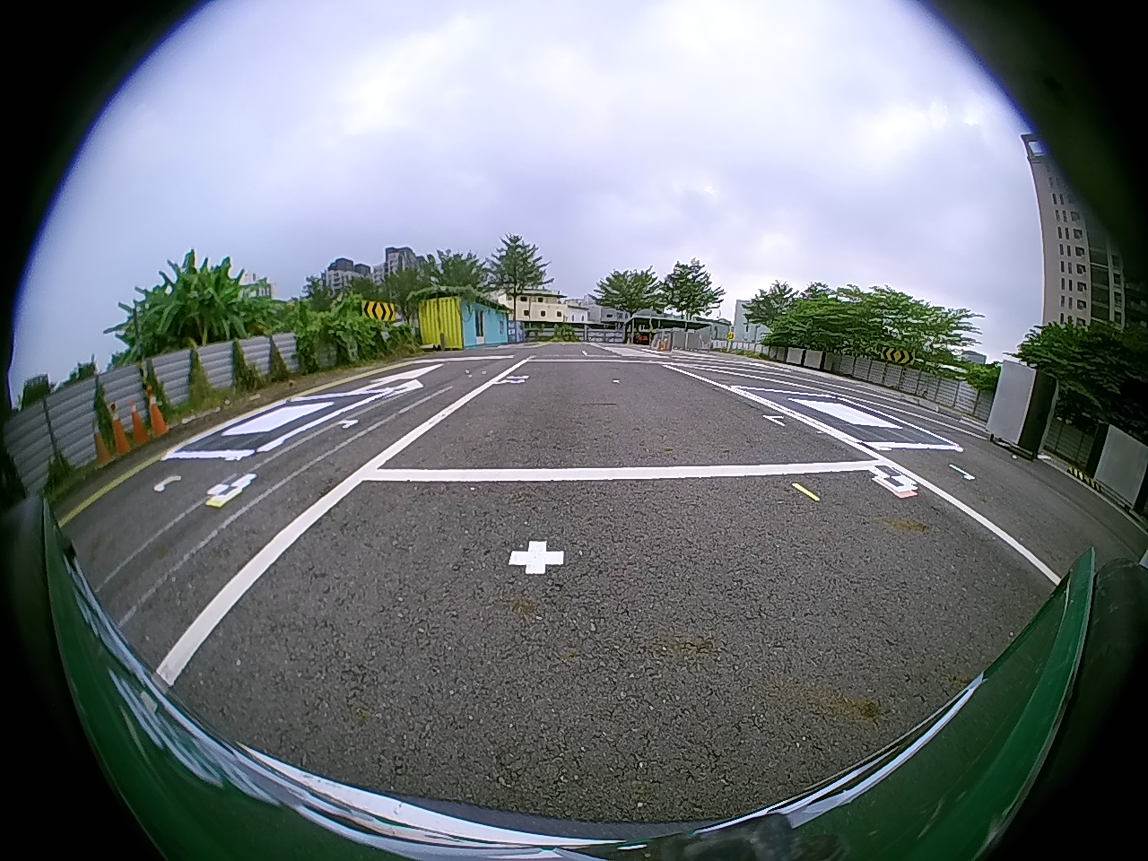

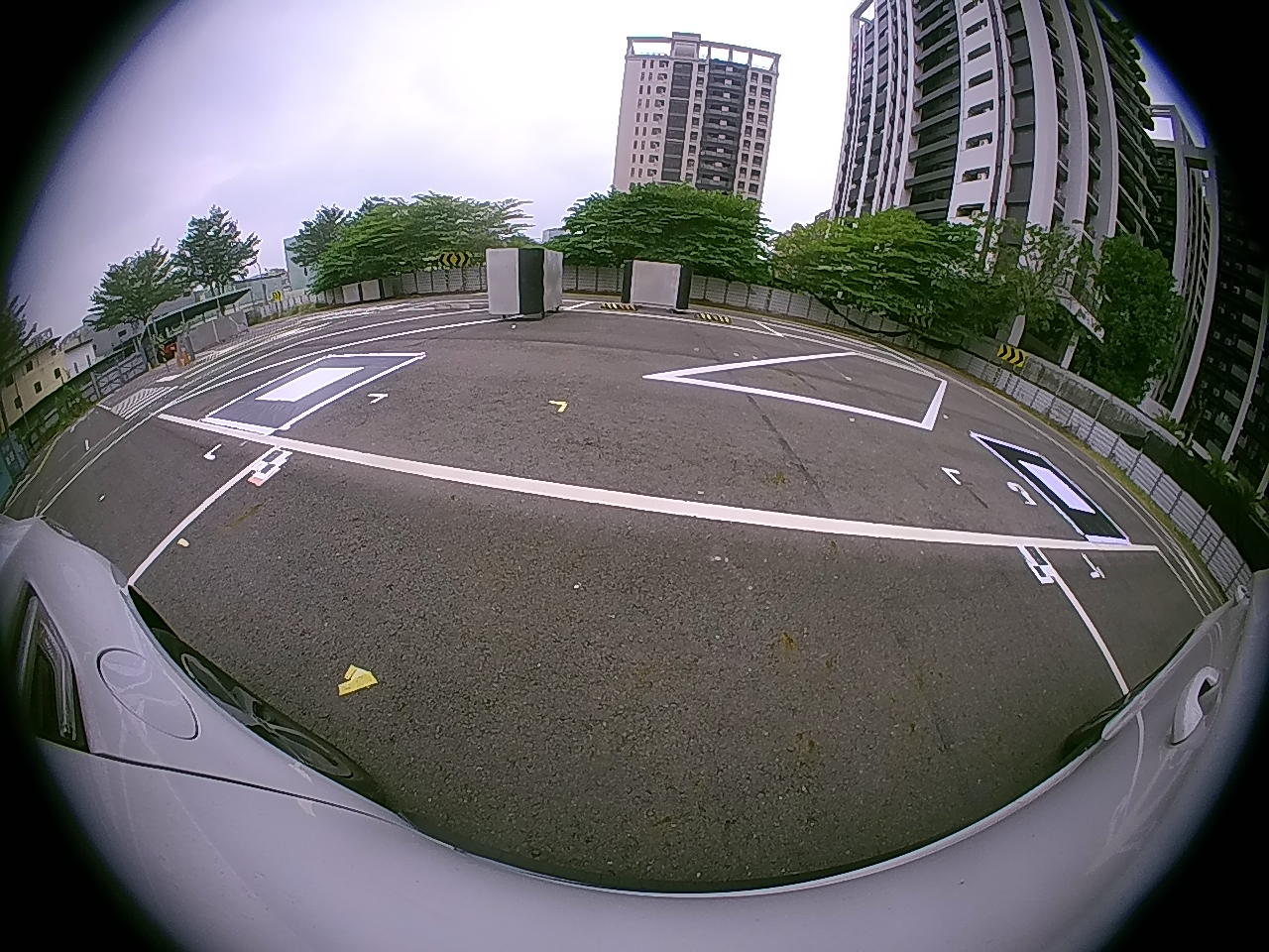

    I provide the original image of my test. From the picture, you can find that the installation position of these fisheye lenses is the installation position of general fisheye lenses.
    Moreover, when I tested these pictures in Surround View on other platforms, there was no such obvious license plate afterimage.
    Can't these afterimages be corrected through Surround View when doing puzzles?

    Also, I have uploaded the original image taken by our fisheye camera, and it looks normal. I wonder if you have any specific suggestions for "adjust camera poses" after reading this?

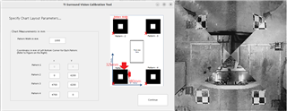

    I test the second set of patterns. And this time the position of the pattern has indeed been adjusted to be closer to the car. But the problem you mentioned still occurs.
    <Original test>
    <The second test>
    So the problem may not be related to the position of the pattern, but to the position of the camera settings. However, the position of the left and right cameras is originally set below the left and right rear view mirrors, so of course it is more forward.

    I think it is normal to install left and right cameras at mirrors. In my opinion, it is better to make the distance between pattern1/2 and pattern 4/3 (i.e. horizontal distance between patterns). And the original test looks better in terms of charts placement. (In the second test, chart space is smaller and car space (garbage output) takes up too much area in the output. I think it is related to internal config). Please make sure that all chart measurements are correct and camera parameters are accurate.
