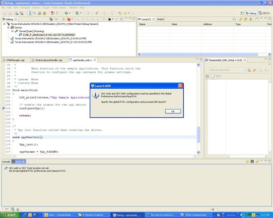

    I am able to add BIOSPSP upp driver to my application & able to load it also. But when first time I am calling  GIO_read to Receive data on RX Channel, code gets hang and I am able to see Following in Debug console
    Thread[main](Suspended)-> _PWRM_F_idleStopClk() at _pwrm_idleGemInclude64P.s64P:37
    Same is the case of BIOSPSP sample also but it gets stuck before main.
    Chandra

    I am trying to run upp Loopback mode for single evm. This itself I am unable to run because code gets stuck at
    even before reaching to main(). I am able to run  PSP examples for other peripherals with same setup (EVM Board and gel file). I also disabled V/F Scaling support  of Power Manager properties which required for all BIOSPSP example to work.
    Chandra

  • Hi Raghavendra,
    I tried pre-compiled upp sample binary to run and it is loading the .out file but I could not see LOG_printf messages as I am getting error message that XDC path /XDC tool is not set. Even though I can see it in preferences window. I attached the snapshot of error message
    Also I am using  following tools
    CCS Version 4.2.4.00033
     Code Generation tool: TI v 7.2.3
    DSP/BIOS: 5.41.10.36
    PSP version:pspdrivers_01_30_01
    I could not load even after recompiling the same upp sample example provided with psp driver
    Chandra Shekhar Mishra
  • Hi Chandra,
    So, by loading the default binaries you did not face any issues. Probably there is something wrong in the build setup or application.
    The LOG_printf messages cannot be viewed in CCSv4 console. You can view it in CCSv3.3. But not to worry, you can even verify in CCSv4 by placing a breakpoint in the application. If you open uppSample_io.c file, line - 387 "LOG_printf(&trace,"Sample Application completed...");" Place a breakpoint at this point and run the application. Hitting this point would confirm working of the sample application.
    Coming to the tools,I request you to install all the tools mentioned in the C6748_BIOSPSP_Userguide - section: 1.2.1,build driver and application and then test.
    Have you done any modifications to the upp.pjt and uppSample.pjt files?. If so, please let us know the changes made.

    I am trying to test uPP on TMDXEVM6657L board.  I am using CCS 5.2, SYS/BIOS 6.33.  Do you have any sample code for me?
    Thank you.
    Steve
  • Hello Steve,
    BIOSPSP does not support/have any UPP sample applications for this(6657L) device.
    Raghavendra
