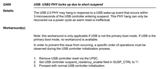

AM64x Errata document was updated in Dec. 2023 and i2409 was added.
My customer has some questions.
Q1) When the workaround will be implemented in TI SDK if not already available ?
Q2) There is no description for "suspend_residency_enable" nor "SUSP_CTRL" in TRM. What are they?
Q3) It is not clear when USB entering suspend or when a USB wake-up event is triggered. Please explain the mechanism.
