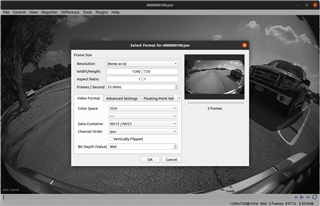

  • Thank you! Can you confirm how exactly is this concatenated images are created.I tried to create the composite image ,but when i try to visualise I could find difference in the color component.
    TI s input image
    Concatenated image created by me
    Apart from the image resolution ,the format chosen is same.Kindly guide.
    Again, this is application dependent. You can concatenate the image the way you want, but please make sure that you interpret this image format correctly when you read the images in the application.
