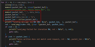

Customer is testing ipc communication between m4f and a53-linux. He got the ti-rpmsg-char code from git-clone (link https://git.ti.com/cgit/rpmsg/ti-rpmsg-char/)) and modified  ti-rpmsg-char code, recompiled it.
I modified the ti-rpmsg-char code to send out any length of data, as shown in the following figure, data_len is the length of the send data obtained from the ssh command line, whereas the original code only issues "hello there %d"
This code is communicatiing to m4f, the function of the m4f side is what is received and what is returned (one thing he already understands is that the user data cannot be sent more than 496 bytes).

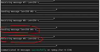

As shown in the following figure, when he sends 256 bytes or less, linux receives the reply from the m4f side in its entirety, starting with ‘s’. End with ‘e’

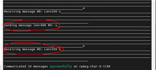

As shown in the following figure, when he sends more than 256 bytes, the linux side only receives 256 bytes of data, and sending 496 bytes also returns 256 bytes. 300 bytes, which returns 256 bytes,
He printed the message through the m4f serial DebugP_log function and saw that m4f actually received all the data, and when it was sent, it was passed in to the RPMessage_send function as long as it was received.
However, if it does not come out, it is truncated beyond 256 bytes.

  • Hello wjj,
    Hmm. I am not able to replicate your results when I do a quick command-line test on SDK 9.0. So the RPMsg protocol itself is working as expected.
    I typed out 496 characters, and sent them from Linux to a remote core. If I tried to send 497 characters, Linux threw an error.
    I then read the message that the remote core echoed back. It looks like only 495 characters were returned (which I didn't expect, that might be something I need to look into - maybe there's something like a termination character that needs to be kept in mind).
