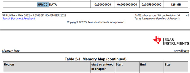

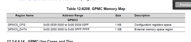

Hi Team,
From TRM, it seems like AM62x only support 128MB.
We need to connect 3 external memories at the same time, nand (800MB), sram (512KB), fpga (256KB).

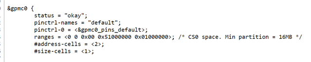

If use 3 external, how to config gpmc dts. From https://git.ti.com/cgit/ti-linux-kernel/ti-linux-kernel/tree/arch/arm64/boot/dts/ti/k3-am62-lp-sk-nand.dtso?h=ti-rt-linux-6.1.y
We can see ranges start address is set 0x51000000, How was this address determined? It related with GPMC0_DATA?
If I want to use  nand (800MB), sram (512KB), fpga (256KB). How to config ranges?
