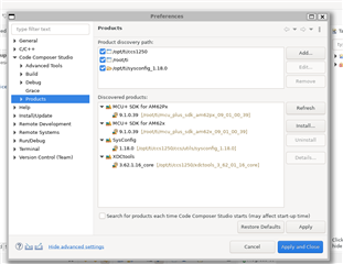

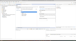

Hi ,
CCS and mcu_plus_sdk_am62px_09_01_00_39 are installed. I am getting an error saying that the device is not currently recognized when I try to import the Hello World project.
Hi ,
Hello Tamizharasan Kumar,
Thank you for reaching out to Texas Instruments E2E support forum.
It seems like the latest version of CCS v12.5 does not contain the patch for AM62P device.
A similar question has already been answered in previous thread. Please refer am62p-device-not-recognized.
