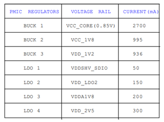

As I refered SK AM62B-P1 the pmic used is TPS6521904RHBR . Can you help me in configuring it through dts corresponding to this
Schematics : https://www.ti.com/lit/zip/spar001

  • i tries myself but i am getting error white booting

    &main_i2c0 {
    	tps65219: pmic@30 {
    		compatible = "ti,tps65219";
    		reg = <0x30>;
    		buck1-supply = <&vcc_3v3_sys>;
    		buck2-supply = <&vcc_3v3_sys>;
    		buck3-supply = <&vcc_3v3_sys>;
    		ldo1-supply = <&vcc_3v3_sys>;
    		ldo2-supply = <&buck2_reg>;
    		ldo3-supply = <&vcc_3v3_sys>;
    		ldo4-supply = <&vcc_3v3_sys>;
    		pinctrl-names = "default";
    		pinctrl-0 = <&pmic_irq_pins_default>;
    		interrupt-parent = <&gic500>;
    		interrupts = <GIC_SPI 224 IRQ_TYPE_LEVEL_HIGH>;
    		ti,power-button;
    		regulators {
    			buck1_reg: buck1 {
    				regulator-name = "VDD_CORE";
    				regulator-min-microvolt = <850000>;
    				regulator-max-microvolt = <850000>;
    				regulator-boot-on;
    				regulator-always-on;
    			buck2_reg: buck2 {
    				regulator-name = "VDDA_1V8";
    				regulator-min-microvolt = <1800000>;
    				regulator-max-microvolt = <1800000>;
    				regulator-boot-on;
    			buck3_reg: buck3 {
    				regulator-name = "VCC1V2_SYS";
    				regulator-min-microvolt = <1200000>;
    				regulator-max-microvolt = <1200000>;
    				regulator-boot-on;
    			ldo1_reg: ldo1 {
    				regulator-name = "VDDSHV_SDIO";
    				regulator-min-microvolt = <3300000>;
    				regulator-max-microvolt = <3300000>;
    			ldo2_reg: ldo2 {
    				regulator-name = "VDD_LDO2";
    				regulator-boot-on;
    			ldo3_reg: ldo3 {
    				regulator-name = "VDDA1V8";
    				regulator-boot-on;
    			ldo4_reg: ldo4 {
    				regulator-name = "VDD_2V5";
                        		regulator-min-microvolt = <25000000>;
                        		regulator-max-microvolt = <25000000>;
                        		regulator-boot-on;

    [    1.143484] VDDSHV_SDIO: bypassed regulator has no supply!
    [    1.150001] VDDAR_CORE: Bringing 1800000uV into 850000-850000uV
    [    1.158105] VDD_PHY_2V5: Bringing 2500000uV into 25000000-25000000uV
    [    1.164884] VDD_PHY_2V5: failed to apply 25000000-25000000uV constraint: -EINVAL
    [    1.172521] tps65219 0-0030: failed to register tps65219-regulator regulator
    [    1.179745] tps65219-pmic: probe of tps65219-regulator.0.auto failed with error -22

    The SK-AM62B-P1 dts doesn't have tips65219 support yet, but you could refer to k3-am62-lp-sk.dts.
  • refering k3-am62-lp-sk.dts I edited the am625-sk.dts and I got the above error
  • Hi Manjunath,
    After compared the board schematics between SK-AM62B-P1 and SK-AM62-LP, they use different configurations of TPS65219, so the DTS PMIC node in k3-am62-lp.dts cannot be directly copied to sk-am625-sk.dts.
    What function do you miss if kernel dts doesn't have TPS65219 information?
  • Above i have provided what i changed in the dts , can you verify it with the am62b-p1 schematics.also attached the error i got.
  • The dev team is working on it but the software is not ready yet.
    What function do you miss without the kernel PMIC driver support?
  • Its working fine without configuring pmic in device.
  • Please wait for the PMIC enabled in the SDK. You can continue using the SDK on the EVM without the PMIC driver at this moment.
