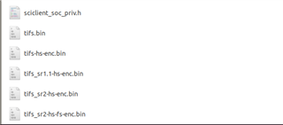

  • Hi Brijesh,
        Based on the chip type I provided, which one should I use from the options below?
    thanks.
  • Hi Ni Hua,
    I am not sure if TDA4VM88T5BALFQ1 is a GP or HS device. So can you please check with your local TI support/FAE to get this information?
    If it is GP device, you should use tifs.bin file.
    For HS device, depending on silicon revision, you need to use either tis-fs-enc.bin (for 1.0 silicon), tifs-sr1.1-hs-enc.bin (for 1.1 silicon), or tifs_sr2-hs-enc.bin for (for 2.0 slicon).
