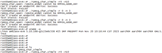

A problem shows in my EVM after the code compiled when I run the RPMSG example code from the website:
However,the default one is OK:

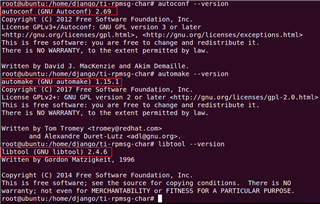

My tools are also OK:
So, what's the problem about the RPMSG example code?
  • When I run the "./configure --host=aarch64-none-linux-gnu --prefix=<target-dir>" command, there is always a error below:
    I can't figure out the "--prefix=<target-dir>". What's the detail information of target-dir?

  • Hello Django,
    Can you please confirm that you have followed the build steps exactly, like in this response:
    https://e2e.ti.com/support/processors-group/processors/f/processors-forum/1307125/sk-am62-ipc/4983481#4983481
    and then tested the generated project, like in this response?
    https://e2e.ti.com/support/processors-group/processors/f/processors-forum/1307125/sk-am62-ipc/4988376#4988376
    (note that the exact rpmsg_ids for the cores in AM62x will be slightly different than for AM62Ax, refer to
    https://dev.ti.com/tirex/explore/node?node=A__AYEyuCg.JDdHqpTk3sF27g__AM62A-ACADEMY__WeZ9SsL__LATEST
    Nick

    root@ubuntu:/home/django/ti-rpmsg-char# export PATH=/home/django/AM62A/gcc-arm-9.2-2019.12-x86_64-aarch64-none-linux-gnu/bin:$PATH
    root@ubuntu:/home/django/ti-rpmsg-char# autoreconf -i
    libtoolize: putting auxiliary files in AC_CONFIG_AUX_DIR, 'build-aux'.
    libtoolize: copying file 'build-aux/ltmain.sh'
    libtoolize: Consider adding 'AC_CONFIG_MACRO_DIRS([m4])' to configure.ac,
    libtoolize: and rerunning libtoolize and aclocal.
    libtoolize: Consider adding '-I m4' to ACLOCAL_AMFLAGS in Makefile.am.
    configure.ac:23: installing 'build-aux/compile'
    configure.ac:23: installing 'build-aux/config.guess'
    configure.ac:23: installing 'build-aux/config.sub'
    configure.ac:17: installing 'build-aux/install-sh'
    configure.ac:17: installing 'build-aux/missing'
    examples/Makefile.am: installing 'build-aux/depcomp'
    root@ubuntu:/home/django/ti-rpmsg-char# mkdir outputs
    root@ubuntu:/home/django/ti-rpmsg-char# ./configure --host=aarch64-none-linux-gnu --prefix=/home/django/ti-rpmsg-char/outputs

    This is my operation log above. Despite the executed file "rpmsg_char_simple" is successfully generated, the run result is still failed on EVM:
  • However, the default one in "mcu_plus_sdk_am62ax_08_06_00_18" is OK. That's crazy if I used the generated one on the EVM.
  • my_rpmsg_test.tar.gz
    This project above is built & based on the "cmake tool" to compile and generate the execute file successfully. As you can see in the files, all the *.c and *.h files are completely copied from the above original project.
    However, it fails to run on the EVM below:
    So ,what's the reason for it? I just change the automake tool to cmake tool in order to create the makefile adapted with the project.
  • Hello, I've solve the all issue commited by myself. I make it much easier by just run the Cmake tool to compile the whole project, it seems to be Okay!
    I should modify the critical word"CMAKE_CXX_COMPILER" to "CMAKE_C_COMPILER" in my project, then evrything is OK!
    Thank you!
