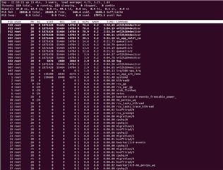

    2.May I ask how can I optimize CPU usage if I use gstreamer for encoding? The "output io mode=4 capture io mode=2" used here did not have an optimization effect, and the settings are as follows:
     snprintf(params->m_AppSrcNameArr[ch] , CODEC_MAX_LEN_ELEM_NAME, "myAppSrc%d" , ch);
                i += snprintf(&params->m_cmdString[i], CODEC_MAX_LEN_CMD_STR-i,"appsrc format=GST_FORMAT_TIME is-live=true do-timestamp=true block=false name=%s ! queue \n",params->m_AppSrcNameArr[ch]);
                i += snprintf(&params->m_cmdString[i], CODEC_MAX_LEN_CMD_STR-i,"! video/x-raw, width=(int)%d, height=(int)%d, framerate=(fraction)30/1, format=(string)%s, interlace-mode=(string)progressive, colorimetry=(string)bt601 \n",
                                                                                                params->in_width, params->in_height, params->in_format);
                i += snprintf(&params->m_cmdString[i], CODEC_MAX_LEN_CMD_STR-i,"! v4l2h264enc output-io-mode=4 capture-io-mode=2 bitrate=1500000 \n");
    and
     snprintf(params->m_AppSinkNameArr[ch], CODEC_MAX_LEN_ELEM_NAME, "myAppSink%d", ch);
     i += snprintf(&params->m_cmdString[i], CODEC_MAX_LEN_CMD_STR-i,"! appsink name=%s drop=true wait-on-eos=false max-buffers=4\n",params->m_AppSinkNameArr[ch]);

  • Yes, I want to optimize the CPU usage of encoding. The CPU usage is high when using the parameters set above.
    Can the data copied from frames be used in shared memory (by pre allocating some memory for recycling). May I ask where the interface encoded in the SDK (08.06.00.12) "app_multi_cam_codec" is located? Can relevant optimizations be carried out?
    There are optimizations to CPU that can be made using DMA by setting v4l2src to capture-io-mode=5 and then have v4l2h264enc use output-io-mode=4. However, this can only be done for specific camera inputs that the driver supports. What type of camera is being used?

    I believe you can use dmabuf framework to optimize CPU usage when using this camera type. I am looking further into it to see what gstreamer parameters need to be set to allow this when using appsrc. I will update you when I have more information.

    After taking a look, to import DMA buffers to be used by appSrc, you need to add the output-io-mode=4 parameter to the v4l2h264enc element. I saw you have a similar thread with Brandon where he walked through these modifications (https://e2e.ti.com/support/processors-group/processors/f/processors-forum/1308410/tda4vm-hi-does-the-app_multi_cam_codec-application-occupy-cpu-resources-does-encoding-and-decoding-occupy-a-high-proportion).
    Outside of these changes, there is nothing else to reduce the CPU utilization from the encoder pipeline perspective. If there are no further questions I will close this thread.

    "There are optimizations to CPU that can be made using DMA by setting v4l2src to capture-io-mode=5 and then have v4l2h264enc use output-io-mode=4. However, this can only be done for specific camera inputs that the driver supports. What type of camera is being used?"
    1.May I ask if GMSL cameras support it?
    2.May I ask what type of camera TI comes with?
    3.What is the CPU occupied by camera encoding when using TI equipped cameras and deserializers? Can you provide a comparative reference data on CPU usage?
    Yueqian
    1. If you go to /opt/imaging and ls the directory, you should see the listed compatible cameras (i.e. ar0233, ar0820, imx219, imx390). GMSL is supported with these arXXXX cameras listed.
    2. Our cameras are typically CSI cameras, but I believe it does not matter what the camera is if it is supported by the driver.
    3. CPU usage should be the same regardless of what camera is being used as long as its supported by the driver. I will do some tests on the camera I currently have with the SDK version you are on and will update you with my results.

    OK, thank you. Could you please obtain the CPU usage status through "top" or "htop" and help me take a picture? So that I can have a more intuitive comparison.
    In addition, besides taking screenshots of CPU usage for a single camera, it would be even more perfect if four cameras could be run to take screenshots of CPU usage.
    Yueqian
  • Hi Yueqian,
    Sure, attached is the CPU usage statistics through top on a per thread basis. This is also with 4 cameras, using both capture->encode and decode->display. I made no changes to the demo code which means it is not using DMA Buf framework.
    Sarabesh S
    All rightI found that the CPU usage is basically the same.
