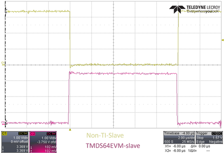

I am running the 'Simple EtherCAT Slave'-demo on the evaluation board mentioned above. It runs among other EtherCAT-Slaves and an EtherCAT-Master with Distributed Clocks configured. The master indicates, that all the slaves are successfully operating in DC-mode. I tried to measure the SYNC-signal with an oscilloscope, but I am not able to see it from the TMDS64EVM-slave. I can only see the SYNC-signals generated by the other slaves within the EtherCAT-network.
I am using the header 'J18 SYNC OUT0' (page 6 in AM64x / AM243x Evaluation Module User's Guide (Rev. A)) to measure. Do I have to configure this header in SYSCONFIG? If yes, please let me know how to do this.

    short update on the measurement of the SYNC-signal: The problem was on my side. I made a mistake in my measurement setup, i'm sorry for your inconvenience. I can assure that the SYNC-header works perfectly fine ;-).

  • Hi Aaron,
    yes exactly, I'm able to measure SYNC0 signal from TMDS64EVM as can bee seen in the screenshot.
    My mistake was that I took the arrow printed on the board next to the header for the GND-symbol and therefore mixed up the polarity.
    Jonas

  • Hi Aaron,
    the screenshot above was taken with the following setup: EtherCAT-master connected to Non-TI-slave, TMDS64EVM-slave and Non-TI-slave (--> 3 slaves in total, connected in this order). But the measurement also works if only the TMDS64EVM-slave is connected to a EtherCAT-master.
