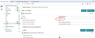

My customer is trying to use BCDMA on A53 core with RTOS SDK.
SDK provides examples and it uses BCDMA channel#0. Please see below sysconfig snapshot.

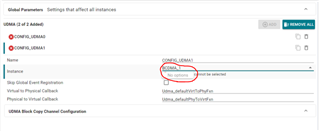

The customer wants to use other than channel#0, for example channel#1, but sysconfig does not have such option.
When they manually modify the Instance to "BCDMA_1", GUI says "No Options".
Is there any way to use BCDMA channels other than channel#0?

  • Hello Koichiro Tashiro,
    There is only BCDMA instant on the AM64X device in that you have to select different channels.
    To select different channels, please follow the below steps.
    Please look at the below image. click the add option for multiple channels.
    S.Anil.

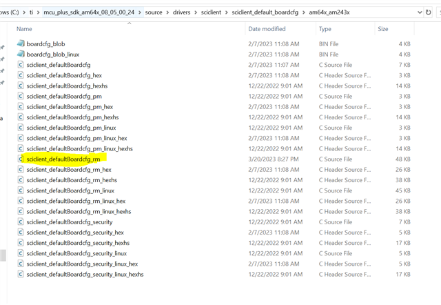

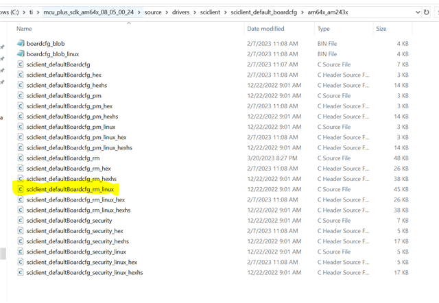

    If the customer  uses  A53 Linux + RTOS CORES( M4F + R5F), SOC uses the resource allocation from the below file.
    C:\ti\mcu_plus_sdk_am64x_08_05_00_24\source\drivers\sciclient\sciclient_default_boardcfg\am64x_am243x
    If the customer uses only the RTOS application and there is no A53 Linux , SOC uses the resource allocation from the below file.
