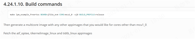

     We want to use LPM to enter MCU-only mode.
SDK:08_06_00_12
board: TDA4VM EVM
    1 We want to start MCU Domain and MAIN Domain by spl. So need porting LPM to MCU1_0, what do we need to do?
    2 in 4.24.1. MCU Only mode — Platform Development Kit (PDK) - JACINTO User Guide (ti.com), where to fetch the atf_optee, tikernelimage_linux and tidtb_linux appimages? Is there an environment to verify it?
    For the very first time R5 SPL can come up on the device but when you go from ACTIVE -> MCU Only mode and then come back to ACTIVE mode, then you need to rely on the MCU R5F application to boot other cores, the R5 SPL will not come up as the MCU was alive and is not resetting. So you need the boot capability in your MCU R5F application. What you need to update is, instead of booting the kernel directly, if you want to have ATF, OPTEE, A72 SPL and u-boot in the mix, you need to boot them instead of the kernel from the MCU R5F application. Please note, this flow is not supported in the SDK.
